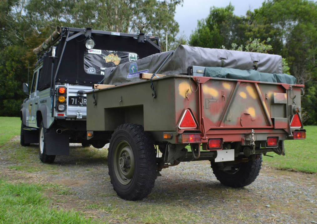

Hi Justin,
doesn't find any picture at your web site with a Sankey connected to your 130.
Mightbe you towe a WT Mk III?
Hi no its a Sankey, your 130 looks very nice, and a fine job you have done on it.
Just as like as I mentioned:
Sankey, wide track, Mark III. :victory:
Main differences to the Mk II is the lower positioned overrun unit right between the draught bar instead of on top on it!
I want one too! :wings:
But it's impossible to get it legal ready for the roade in Germany! :Wow1:
No paperwork for the disk brakes --> no admission by the DOT!
I'm not amused about that. But can't help it.
Btw, the tub of the 110 HCPU matches perfect on top of the WT frame!
The tub of the 130 CC is a little bit too short for a real good balance. But it might be extended in front of it.
