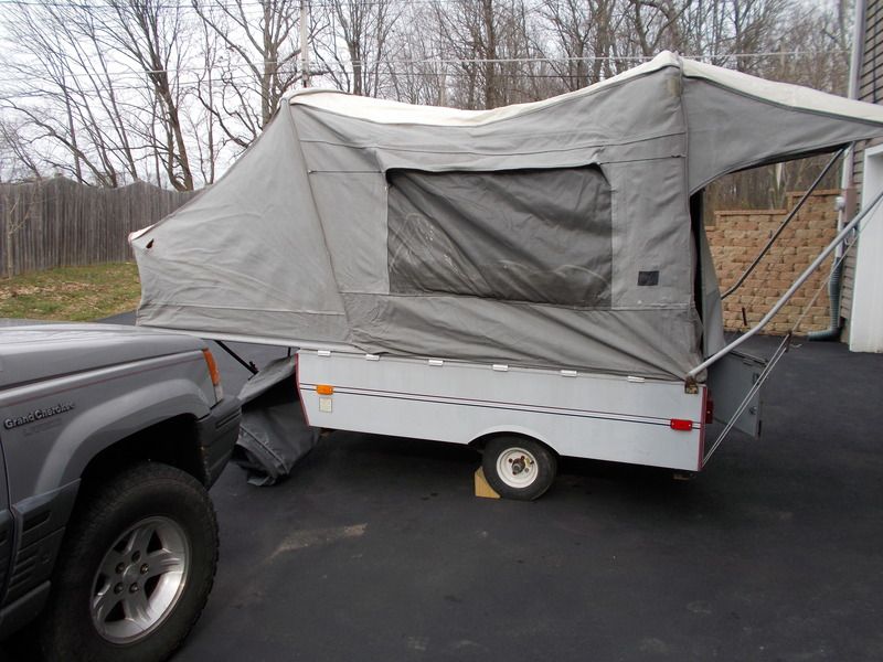

Different rig and a small pop up have replaced the older gear. I have found locally two Coleman Colorado's in need of repair, one much worse than the other. One has a replacement canvas that I hope is still salvageable after 4 years and the other needing floor repair and canvas replacement. The idea is to clean the Bear Creek replacement and install on other trailer.

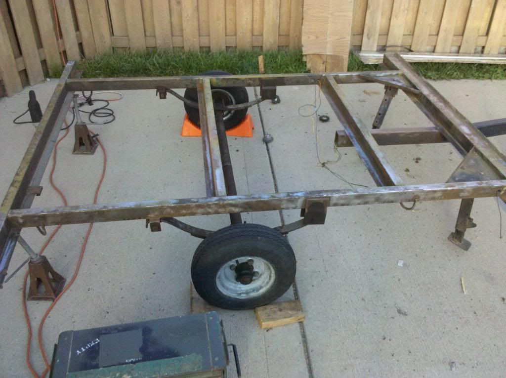

My plan is to strip the better trailer to the frame, reinforce the frame a bit and reassemble with all new wooden structure. I'd like to ask those who have rebuilt if they have done any reinforcing, it looks to me as though the Colorado's frame could use some.
Here's a pic of a stock frame, photo credit to JetNoise here on the forum. He shared his PB account and I'm glad he did, gave me tons of ideas and sold me on one of these trailers.
I think I'd like to start by adding a few crossmembers, extended tongue, rear receiver, and boxing in the sides of the trailer a bit better. Suspension and axle swap may have to wait, a spring over and larger tire is planned. Unsure on size as yet, need it to ride level behind a ZJ on 31's.
Anyone have any input on how they beffed up their Colorado? Short of slipping an M116a2 under it.. which is a great build BTW.
Here's the setup as it sits today.

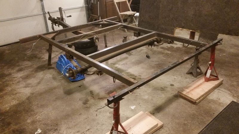

OK, so no input on the frame strengthening. I think i'll be cutting the two center crossmembers shown in pic abaove.. and add them to the other frame.. one fwd and one at other end. Some other strengthening, i'll get to know my 110 Lincoln welder finally.

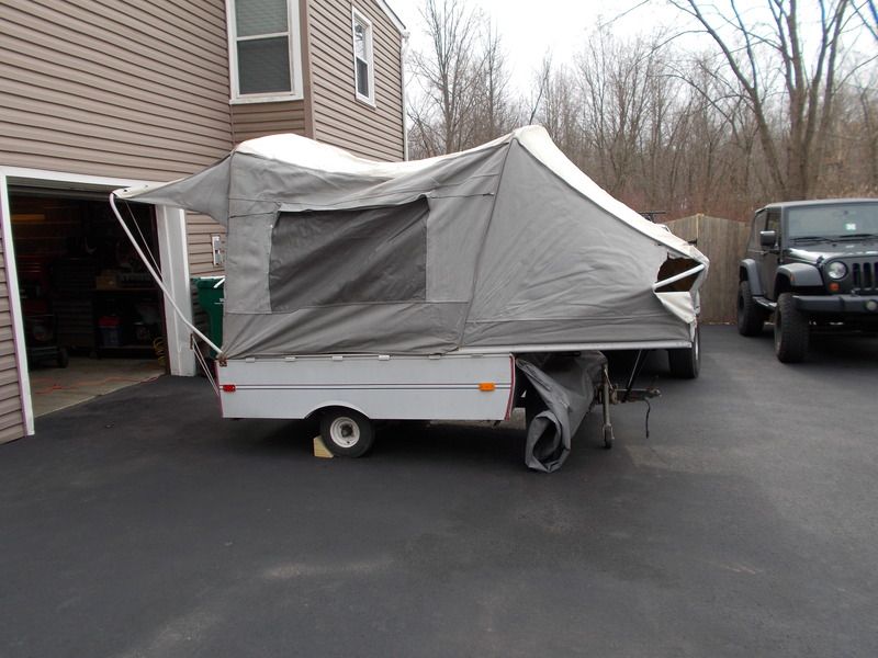

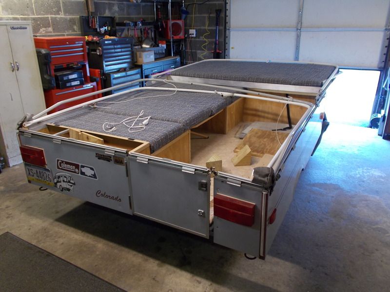

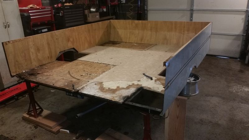

Yesterday I towed the trailer to my son's house, he has a 3 car garage and plenty of room for the project. We tore the old canvas off, removed and inspected bows. Some need work or possible replacement from my second parts Colorado.

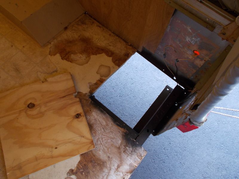

I never opened this trailer when I purchased it, although I had several photo's. The rear right corner was soft and the issue that had owner sell it after tearing into it and reconsidering. The whole floor to the side of frame rail seem to dip down.. I definitely need to gusset the corners.

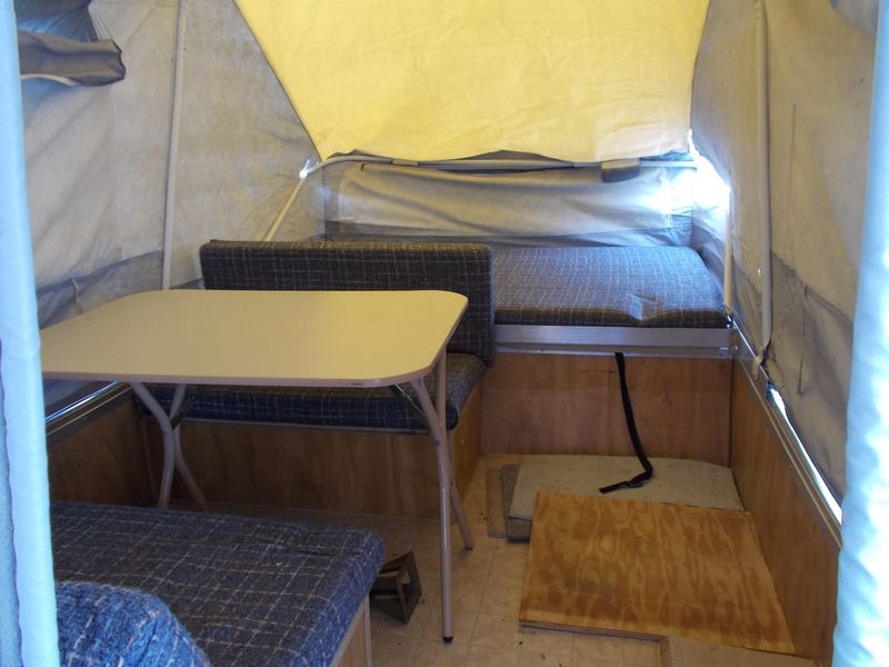

Here's a few pics as purchased, I opened it up for the first time yesterday. Pretty much as expected but with damage to a few bows that wasn't disclosed.. again I have a second trailer in much worse condition for parts. In total I have $250 into both their purchases.
The soft spot in floor where the last owner gave up..

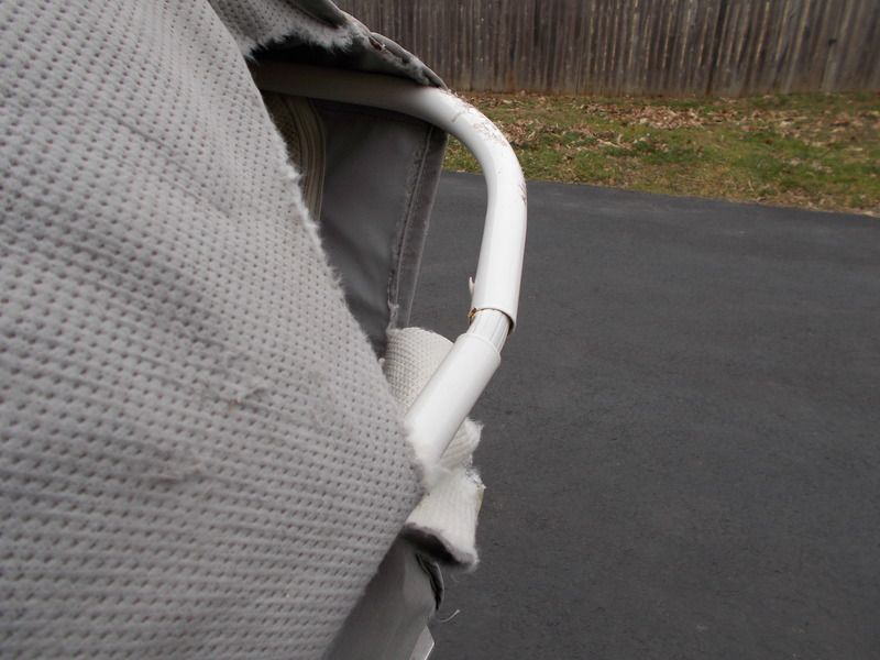

The front bow.. bent pretty good, probably from improper closure. I'm hoping the inner sleeve is a generic Coleman adjuster piece and available if I don't have it covered.

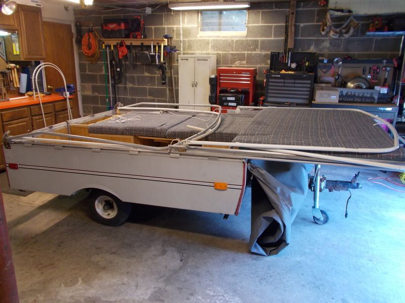

Pushed inside and disassembled bows, took some pics of the hardware/bracketry and started looking things over and making plans. That's about as far as we got the other day. Son lives about 45min away so I wont get to work on it everyday but the plan is to have it usable come March so I can get out for my birthday.. wish me luck.

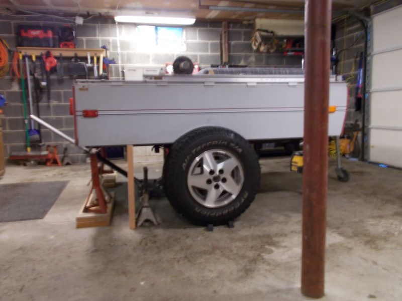

The plan is to fit up to a 235/75/15 wheel/tire package on this trailer using wheels that match the Grand Cherokee. The wheels have 5.5" backspacing and are 8" wide with 5 on 4.5" bolt pattern. The tow rig sits on 31's so i'll need to think about a spare as well.
I have a near new Dexter 2000# trailer axle in garage, bolt pattern will work but the axle is about 5" too wide at 70". The original is about 59". Neither will work so im going to order a new 65" 3500# axle along with suspension from www.abctrailerparts.com. I'm also gonna need to dremmel out the hub on the wheels I plan to use. I also came up with a plan to add crossmembers to add support to new floor including boxing of the frames corners.
Took good measurements and photo's of how the trailer came apart, hopefully it goes back together the same.

New axle, leaf springs, 2x2 tubing and additional steel pieces are acquired and stored in garage.
The leafs have a 1" wider requirement for the hangers, i'll be cutting off the rearmost at slider bolt and replacing for a shackle hanger (which I forgot to order along with shackles). I think i'll make them both..
The 2x2 tubing will be to box out the corners of the trailer, in front and behind tires on both sides. This will prevent the flooring from bowing down on the outside portion of floor beyond the main frame rails. I have wider c-channel I'm repurposing for between rail crossmember's to support between the factory z shaped crossmembers.
