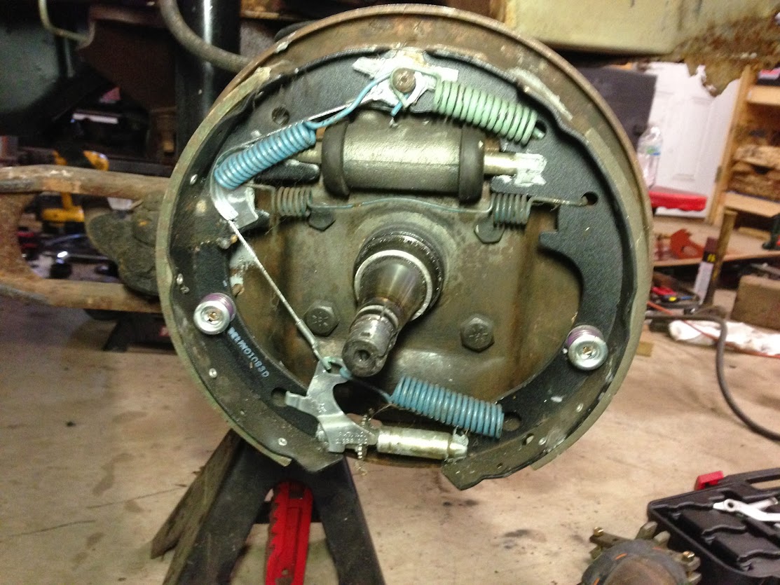

This weekends project was front disc brake conversion.
Purchased a caliper bracket from Scarebird.
Off with the old.
and on with the new.
It did require a change in MC and proportioning valve. And the obvious - rotors, calipers, pads, and soft lines.

Sweeeet! That's on my list as well for my Dodge. Your old brakes looked pretty good btw.
Thanks! The drum brakes were a fairly fresh install. I dont have a working odometer so i have to gauge things on gas tanks. Id say those brakes have 4 tanks of gas on them (1.5 years) . I dont drive the van a whole lot yet.

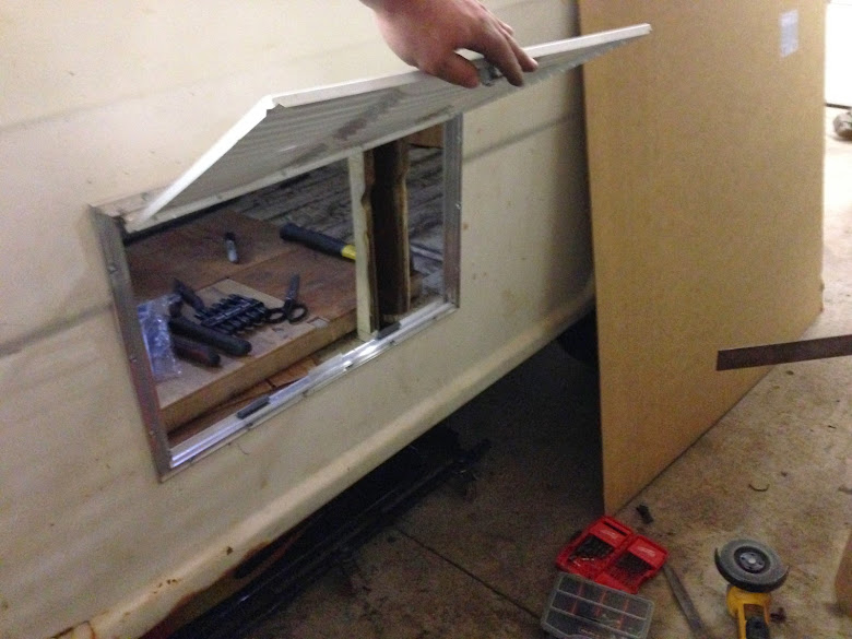

Installing the vents.
