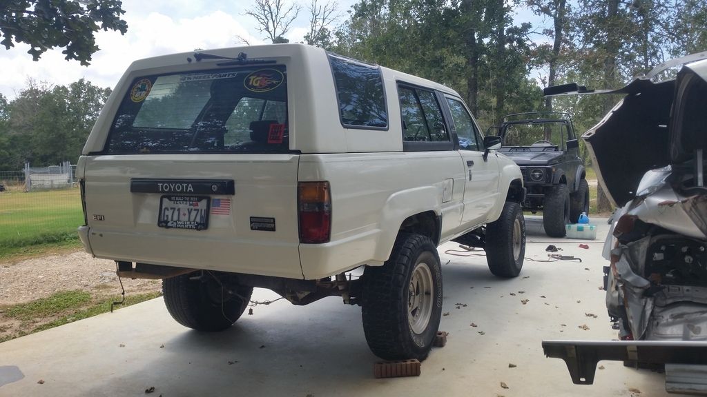

I've had quite a few toyota rigs through the past and I've always wanted to build a first gen 4Runner. My searching turned up a 1989 blue 4runner that looked to be in great shape. That's when I learned that you NEVER buy a 4runner that has rhino liner on the rear fenders! I started poking and found that both rear fenders and rocker area was GONE due to bad rust and was covered up with literal gobs and gobs of urethane caulk. After that disappointment I decided to find another non-rust 4runner, that's when I found a white 1986 22re 4runner. It had been a long term project this guy was selling on Craigslist so I picked it up. It has ZERO rust and was exactly what I was looking for minus the huge wide wheels/tires and 3" body lift. The engine and transmission were both in the back of the runner when I picked it up.
Mods when bought:
-4:88 gears front and rear
-front lock right locker
-all new weather stripping(Toyota)
-rebuilt short-block bored oversize with receipt from machine shop
-rebuilt w56 transmission with receipt
-all new front end parts and steering.
Day I picked it up:
At home:
I then removed the 3" body lift and installed polyurethane body mounts, then I sold the 33x12.50r15 wheels and tires. I also removed the rear bumper to make room for a marlin or trail-gear rear bumper:

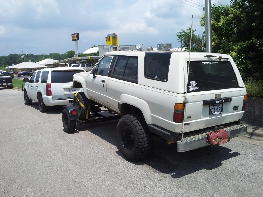

that thing is clean!! nice
looks like you didn't have the rear driveshaft in there for the tow home(?), but for anyone reading this who doesn't know better, never flat-tow one of these early 4runners; either lift the rear, or remove the rear driveshaft.
bkg
My first thought as well
