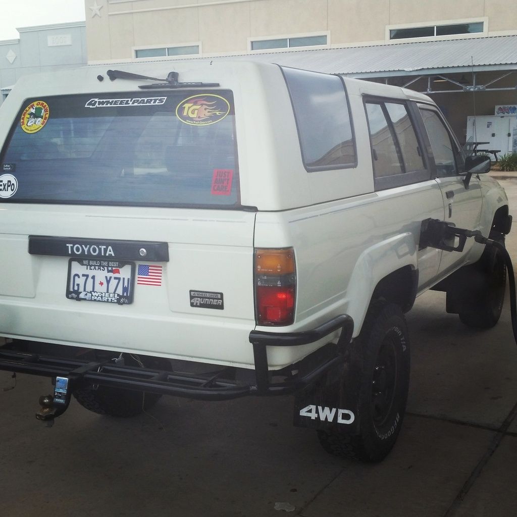

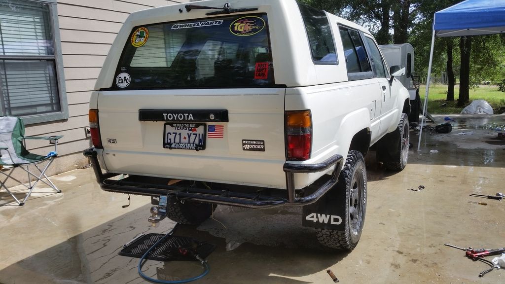

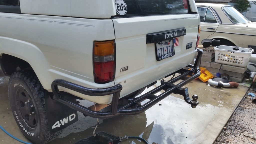

-Installed trail gear rear tube bumper(very well made for the $$$)
-Installed new gas tank with new sending unit, fuel lines, fuel pump holder, and fuel pump.
-Installed front brakes and bled the entire system(needs new master cylinder and booster)
Trail gear bumper:

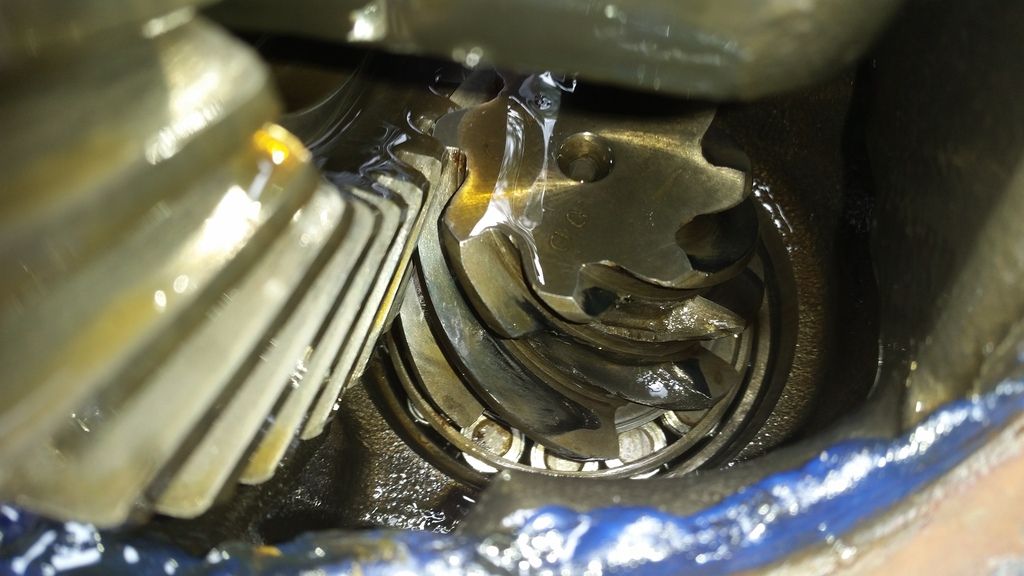

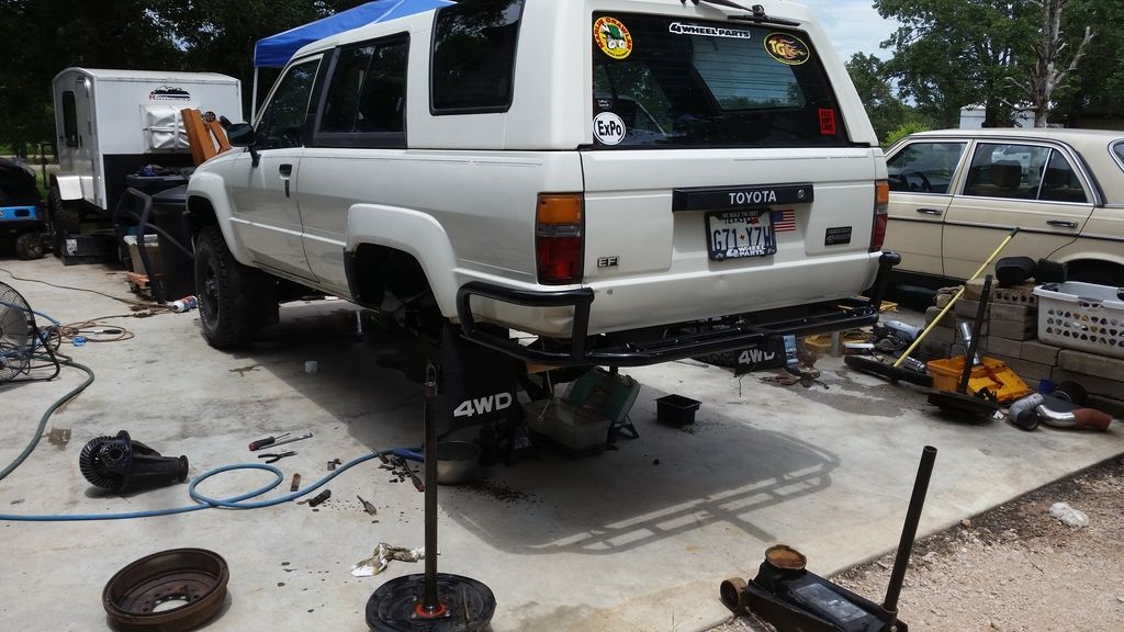

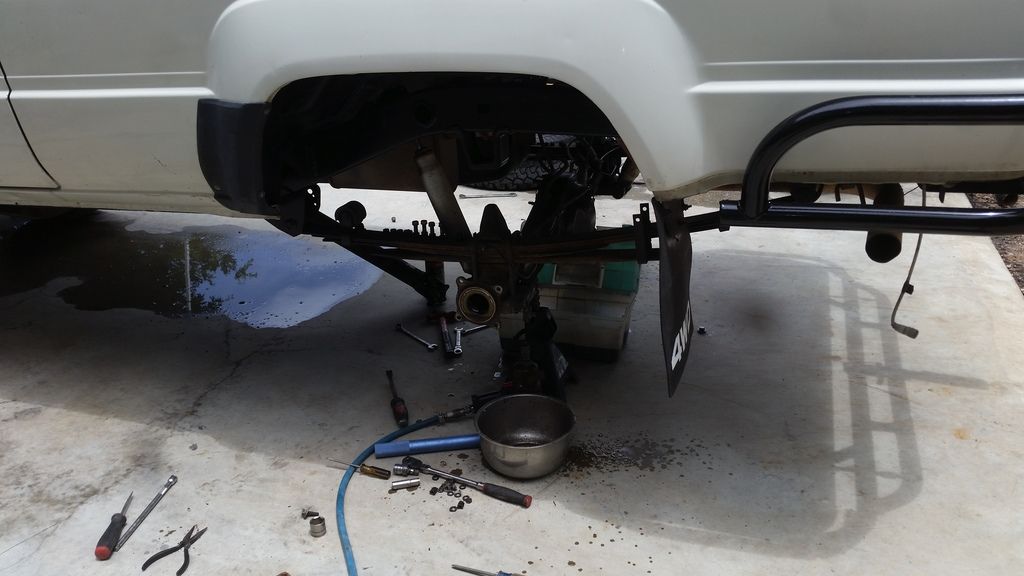

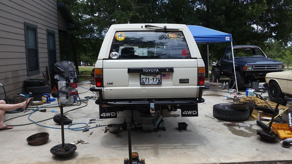

Took it on its first test drive when I heard loud banging noise coming from the rear differential, pulled it apart to find this:
4:88 rear diff trashed...
The biggest part that peeves me the most about the diff is that the guy I bought it from gave me this big rant about how he'd "been screwed by all these sellers in the past" and how he's honest, blah blah blah.
After seeing the rear diff carnage I decided to check the front diff.....well despite the HUGE amount of play on the pass-side axle flange coming out of the diff(which almost bangs part of the frame), the locker and diff work fine.
Luckily I have a good spare 8" 4:10 rear third member and a good 4:10 complete front ifs diff assembly so let the swapping begin!
I still need to swap out the front diff assembly, I'll finish that up this week. But it drives pretty good, no vibrations or weird noises.

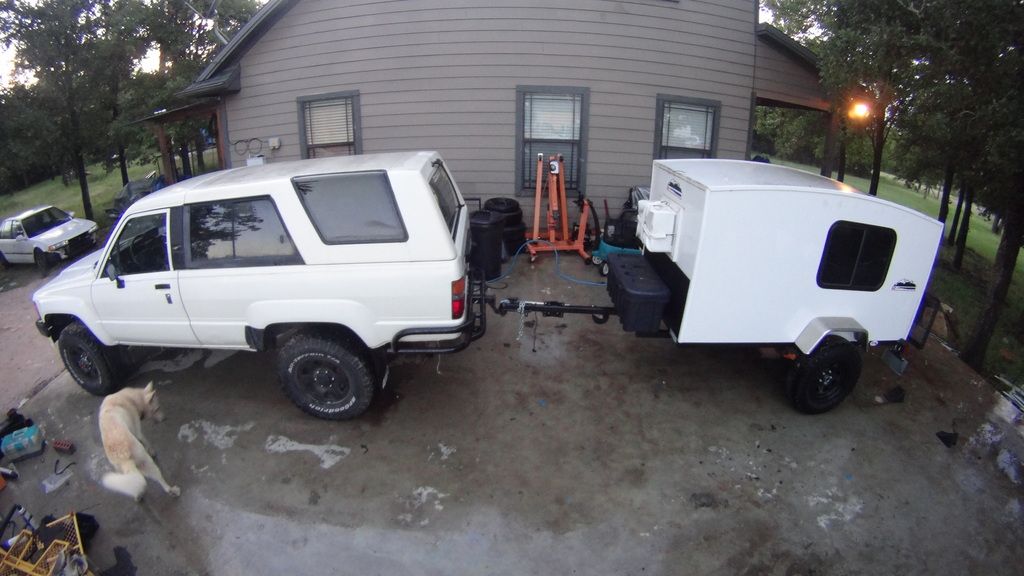

I got a little ancy and hitched up the camper to see how it looks, I'm definitely happy!:)
austintaco
Very nice! Are you going to keep the 4:10 gearing or try to source or order another set of 4.88's? I ask because of your trip to CO. My wife and I go up there every year (I'm getting giddy just thinking about it), but I would think that towing anything with the 22re and loaded up might make for a looong day on the road.
Casebite
My plan is to rebuild the 4:88 diffs and install them back for the ease of towing, for now the 4:10s are going to make due. The trailer is pretty light so I should be ok going up passes just not very fast at all.
