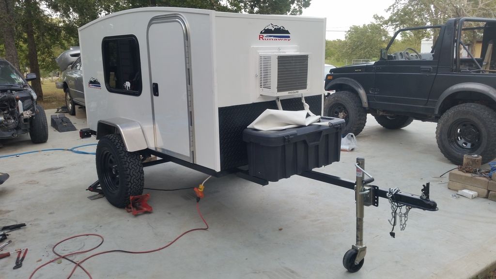

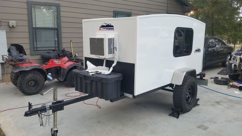

Sweet build indeed! Haha that trailer is literally a bed on wheels! Looks awesome and lightweight to trailer too.

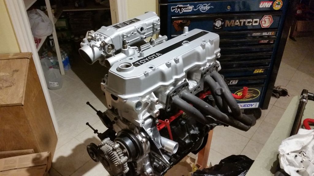

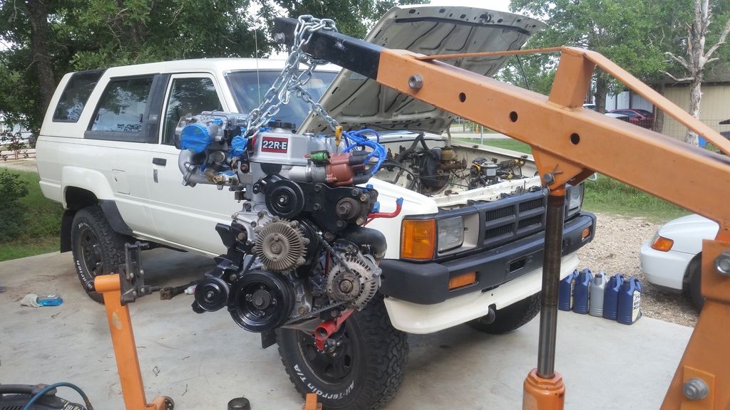

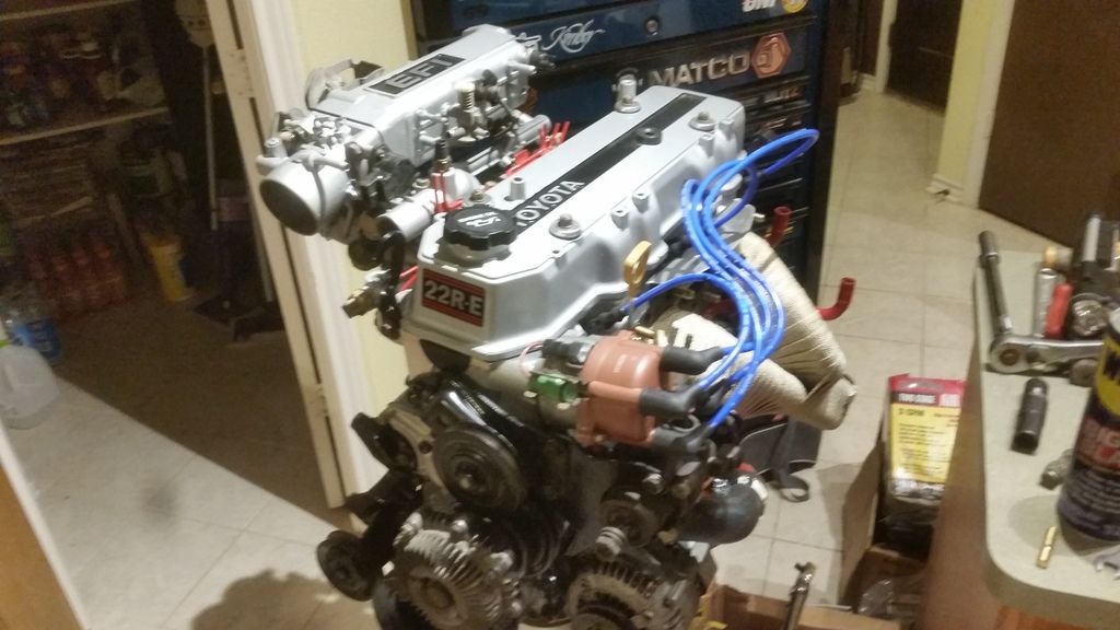

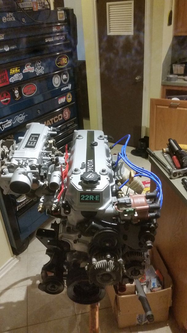

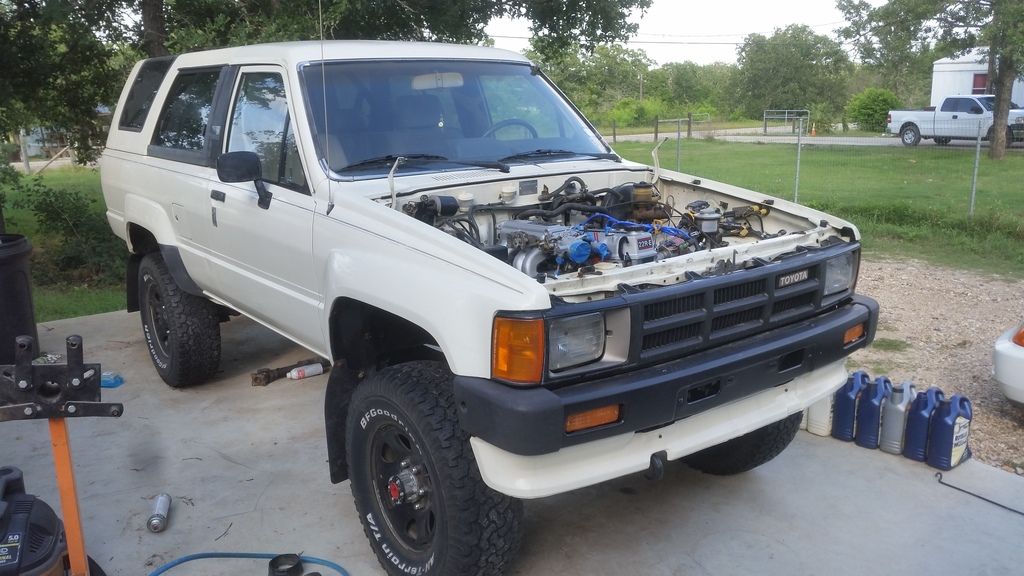

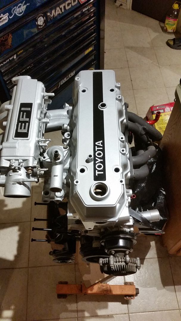

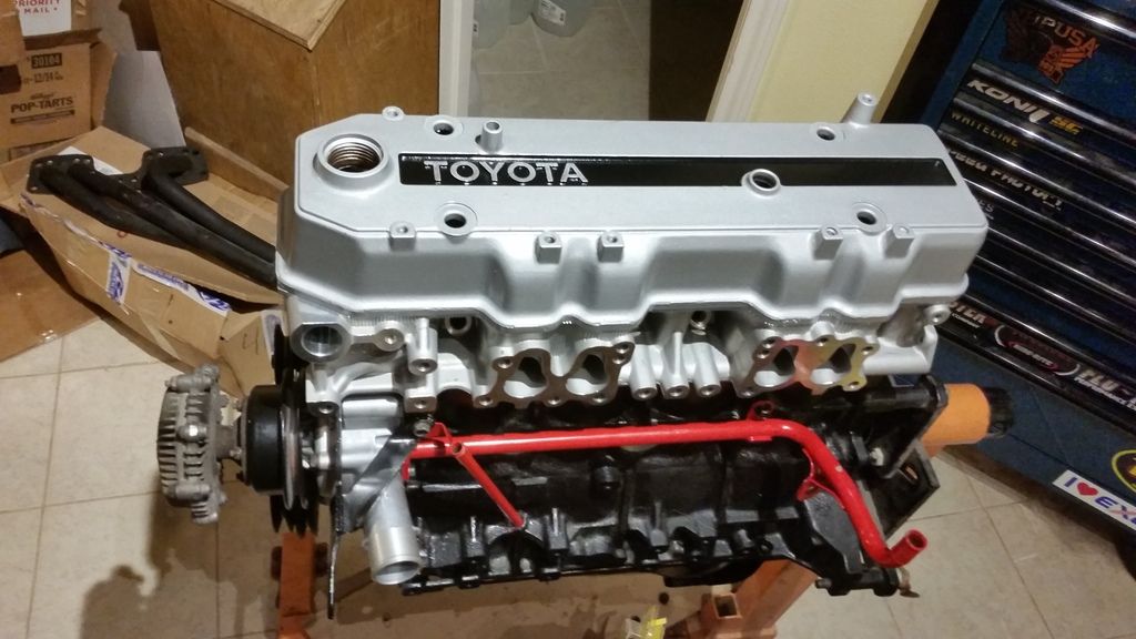

UPDATES:

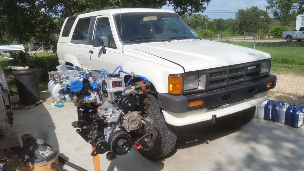

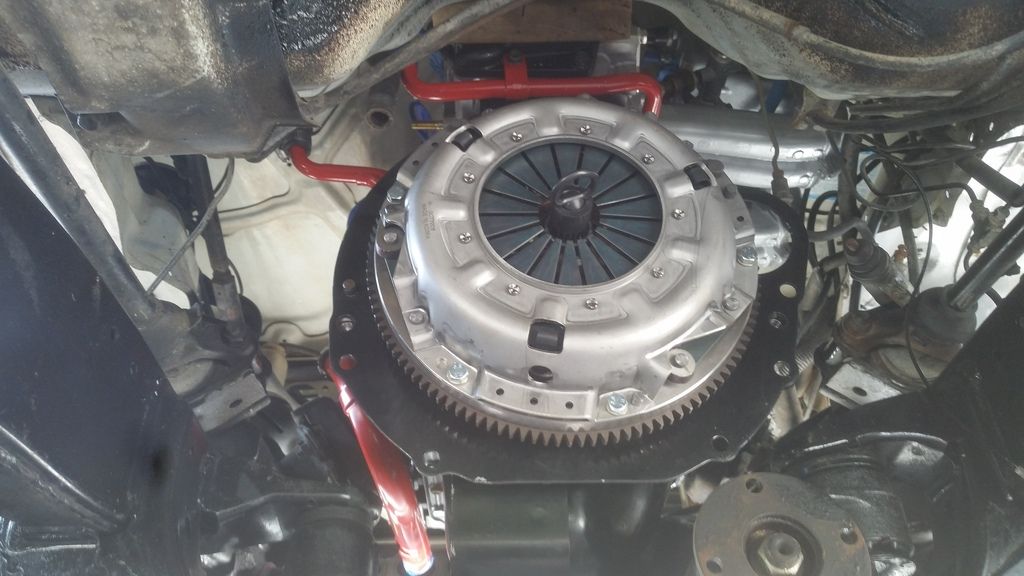

-Got the w56 mounted up and filled with synthetic fluids

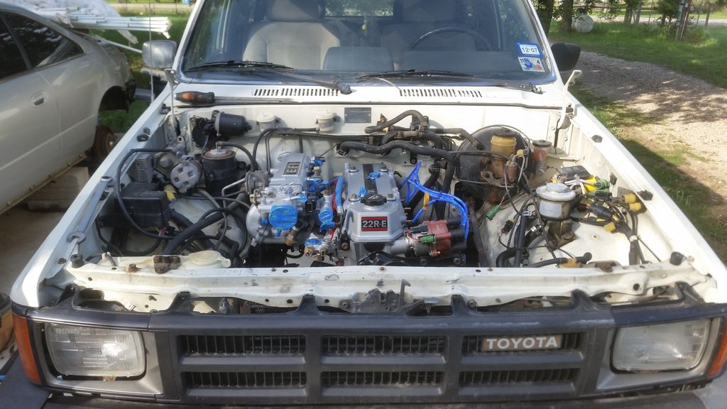

-Had to repair part of the engine harness(looks like someone didn't disconnect the acv connector before they pulled the engine):(
-Got everything on the engine buttoned up and finally started it up! Idles well!

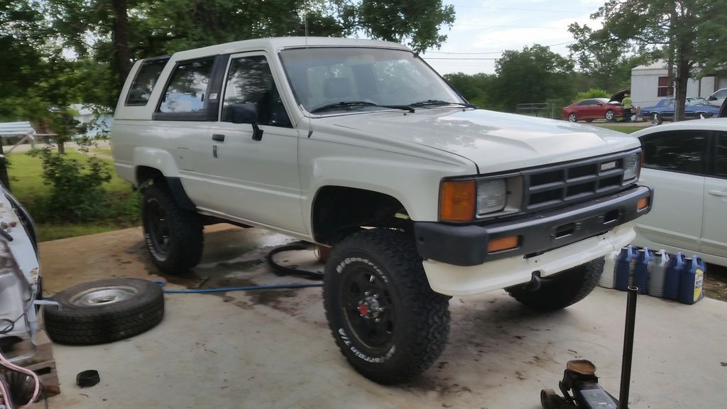

-Finished the exhaust work, 2.5" to the catalytic converter, then to a Magnaflow chambered muffler.
-A/c is all hooked up and flushed, ready for a new dryer, vacuum, oil, and charge.
-Installed trail gear rear tube bumper(very well made for the $$$)
-Installed new gas tank with new sending unit, fuel lines, fuel pump holder, and fuel pump.

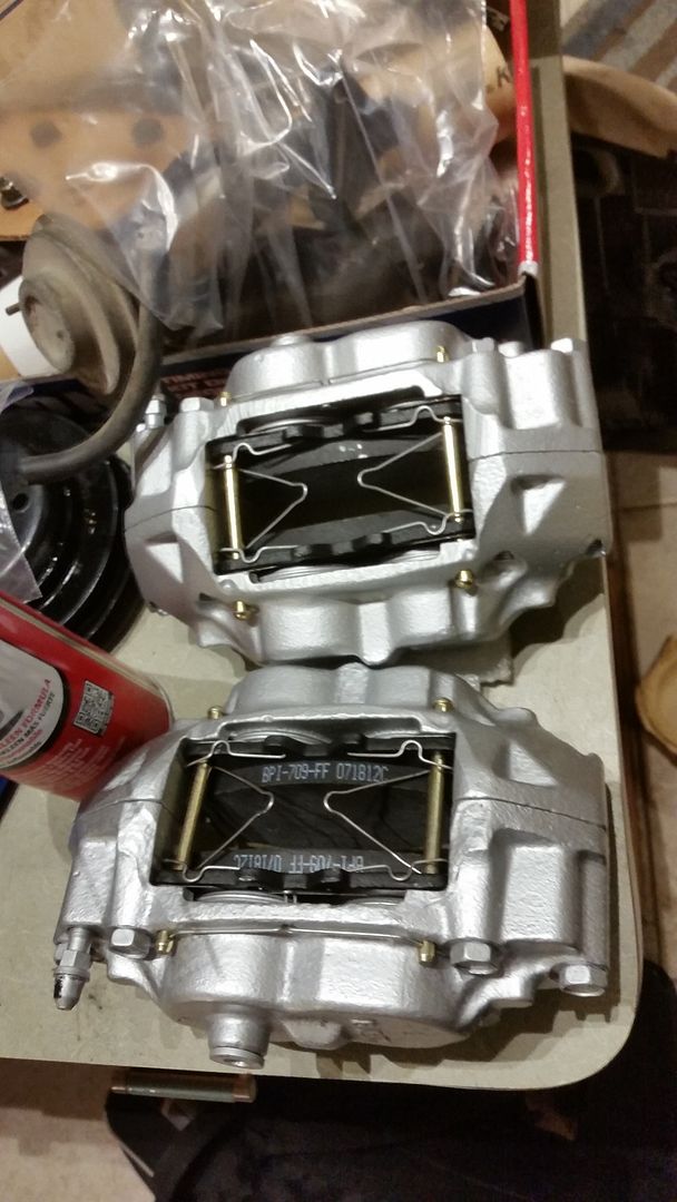

-Installed front brakes and bled the entire system(needs new master cylinder and booster)

I still need to swap out the front diff assembly, I'll finish that up this week. But it drives pretty good, no vibrations or weird noises.
First fill up!
I got a little ancy and hitched up the camper to see how it looks, I'm definitely happy!:)

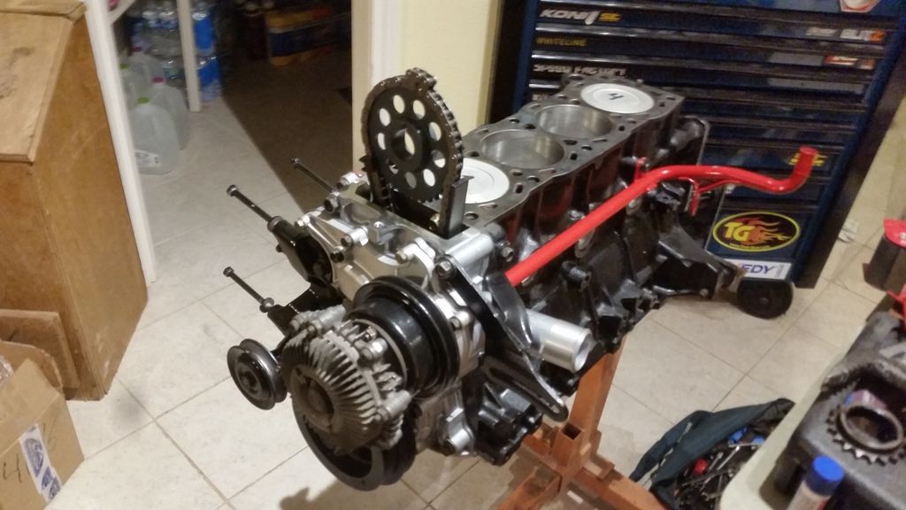

150miles, 3rd oil change, and counting... still running great, has alot more torque/power than previous 22re engines I've had in the past.:ylsmoke:
