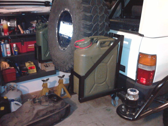

I need to get the bumper built so I can tow my M101A2 trailer around to see how the 4runner does towing it so I can decide if I will end up using it or building my own smaller trailer for expo use. This is what I have in mind for rear bumper, but with dual fuel can holder and fold down tray.

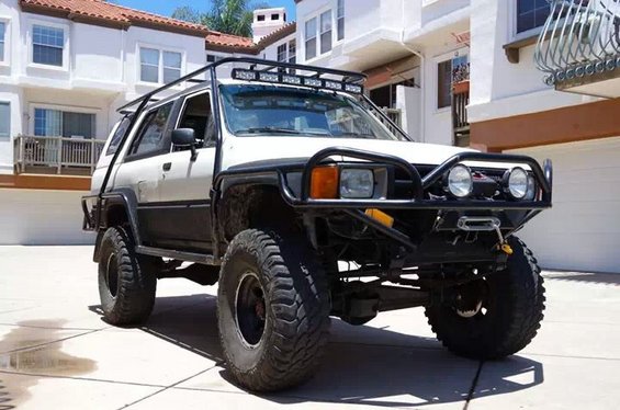

I am debating with building a system like this that would mount to rock sliders and rear bumper, but would be removable when not needed. I am not sure if I want the added weight though, so also debating just building a basket for the top to save weight. I am kind of waiting for building the rear bumper to see how the 4runner handles the trailer, because I may end up just mounting the tent on the trailer only.

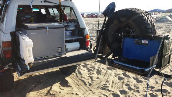

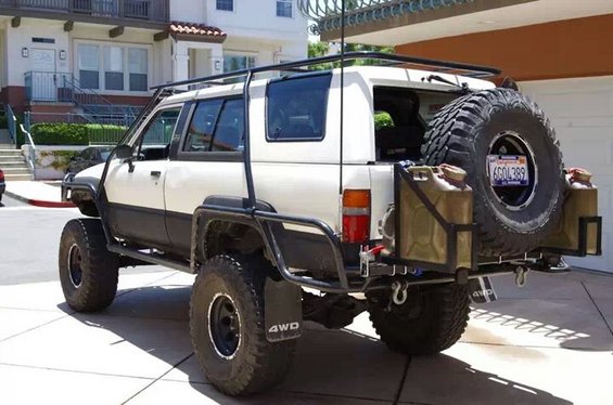

Great build! Seems like your build is turning out like mine except for the 3.4 (I wish I had) and LT. Just food for thought this is how I did my bumper and rack.
I used tube clamps to mount on the bumper so I can unbolt them if needed.
Used a spare spindle and hub assembly to make the hinge. Super strong, fully serviceable, and it acts as spare parts if I ever blow a hub.
The hub also allows me to lock the swing arm in different positions which helps out when camping on a hill or need extra table space. The fold out table is extremely useful.

How much noise does that rack make going down the highway? One of my concerns with doing that style is the added wind noise and lower mpg. Pretty sweet setup you have there with the hub
Sr5trd99
Thanks. I can't hear much wind noise over the tires and engine so I'm guessing its not to bad but then again the tires and engine are pretty loud. As for MPG I normally get around 15 to 17 mpg which is pretty good for all the weight I've added.
