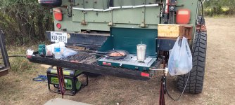

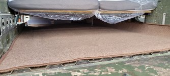

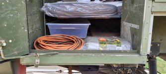

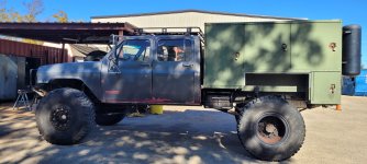

So it has been a while since I updated but for the most part I have been driving the truck and working out little bugs. I ended up installing bigger lift rear springs to get rid of the sag in the rear that I had, while I was at it I replaced the rear main eye hanger. Over the last six months I have started to try to rough out the camping area in the back, a couple weeks ago my youngest son and I took the truck out for the weekend and did a little shake down. Everything work well, I found so things I want to move around but my son had a blast and that’s what its about!20231112_141453.jpg

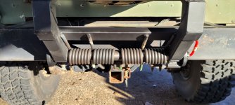

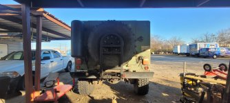

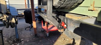

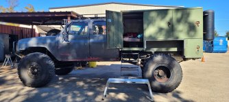

Been a crazy year, I had a turbo go bad and had the input shaft and counter shaft blew up in the transmission. I have come up with most of a plan for how I want to layout the box and that project will start soon. I have just finished my current attempt at a heavy duty spare tire carrier, It is made up of using trailer springs to help raise the tire back up. I also finally installed a set of RV steps that I narrowed for getting in and out of the box.
ITTOG
Well-known member
How much assistance do the springs provide? Any idea what the wheel weights and how much force do you have to apply to raise it? Looks like a great idea and definitely beats adding a winch.
