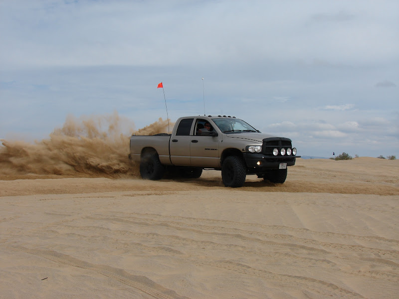

Personally, I don't think I could ever go with a poly bushing in a vehicle that was going to be offroad alot. Plenty of ways to argue the pro's and con's of poly vs. heim joint. Here's what I have on my 2500.

37's on a 3rd gen..... depends on how hard you offroad and how true of a 37" you have (Toyo MT's are 37.1" but Yokohama AT's are like 36.5), you might have a little fender rubbing. I'm running Toyo MT's and with Carli springs on all 4 corners with the arms, I had some rubbing on all the fenders.
