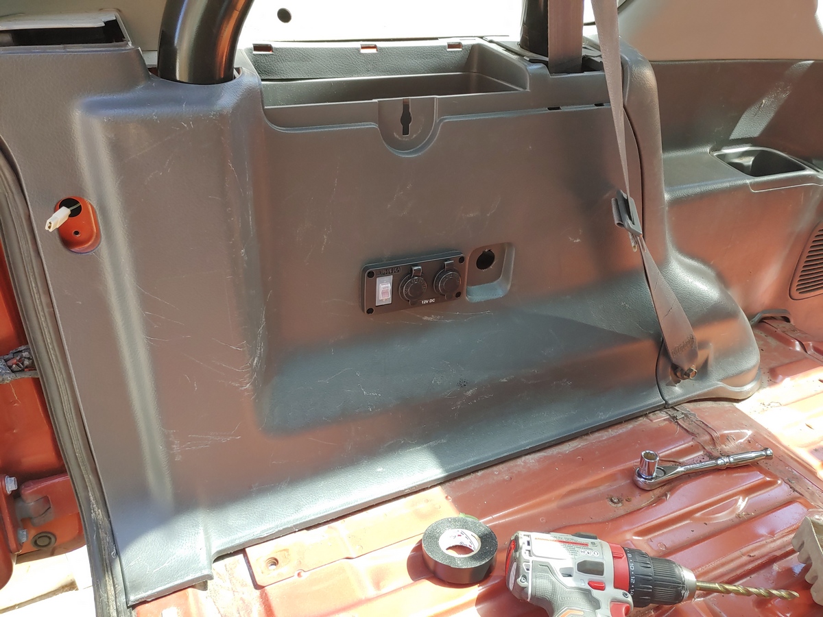

So, I did the first "real" overlanding sort of addition today. I got help from both a member here and from BlueSeas themselves, but I wired a new panel to be able to run items from the rear of the Meego.
So, first, here's the panel out of the vehicle. Driver's side, rear.
Closer look at the back of this flimsy accessory outlet? ENHANCE!
Let's look at the stock wires and see how they look!
They were live, but wouldn't run much. I should mention that I took the interior apart to put in a body lift and to find out the source of the water in the carpet. Both of those beign accomplished, it was time to tackle this.
So, I got 18 feet of 10/2 marine wire to run from the back to the battery. As per Blueseas, they preferred going negative to battery as opposed to ground. I did check and it worked on a spare battery, so here's to hoping. So, I ran the wire front, behind panels, and through an existing firewall hole and to the battery.
Now, I also shielded the cable under the hood and will be running it above the A/C lines to the battery location. I will have a picture of that later.
Here's the finished panel...I just need to blank out the previous hole!
