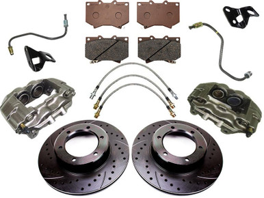

Brake Upgrade Kit
Based on 2002 Tundra parts selected by me after reviewing number of build threads purchased through RockAuto. I selected the most heavy duty towing rated parts available through Rock. There are complete kits available. Pics have part numbers for those interested in this upgrade.
I recommend this as the most valuable upgrade a 1 Gen Taco owner should do. Have to upgrade to a 16 or preferably 17 in wheel with enough negative offset to clear the Tundra calipers.
4_20190815_103207.jpg0_20190815_103406.jpg1_20190815_104813.jpg6_20190815_103035.jpg3_20190815_103040.jpg2_20190815_103029.jpg
hard lines and clips from Toyota
Screenshot_2019-08-28-20-09-46-565.jpeg Screenshot_2019-08-28-20-18-31-296.jpeg
Not shown custom stainless steel braided lines I had custom made. These can also be ordered as a kit which in hindsight I should have done.
I bought all parts for about half the kit price but problems related to a Toyota 4WD drive specialty shop in Mesa AZ cost me about three times the kit cost. Avoid the "toy" shop.IMG_20191115_154936.jpg
New booster, master cylinder and rear drum cylinders also done.
