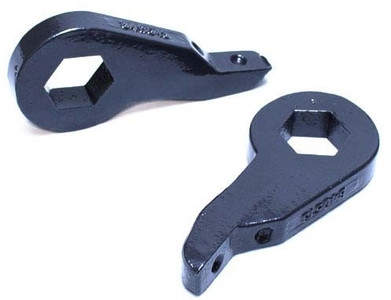

Hmmm. I thought the gmt800 4wd suburban had torsion bars and the 2wd had coil springs. None of the lift kits swap between the two. Now maybe you should shut up, crawl back under your mommys skirt, and let the adults finish talking
Lots of the 2wd trucks had torsion bars, including the Suburban I owned, 2000 GMT800 1/2 ton. But hey, keep name calling, if you use caps maybe more people will listen.
In any case, putting and actual “lift” with drop brackets, etc, on that vehicle is a waste of $.
