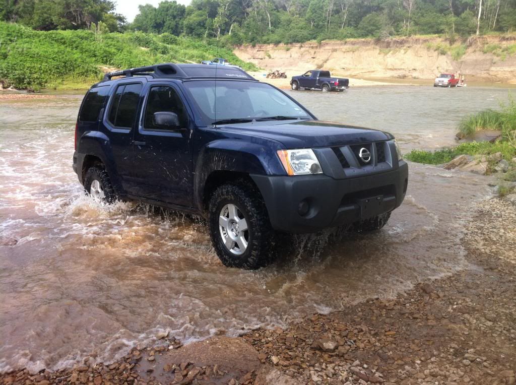

Thanks for all the info everyone. Because of you and the people over at ThenewX I picked up I'm confodent was a solid purchase. I just bought an '06 X model, MT, 4x4. It came with undersized tires and 117k miles. With no timing chain whine and only minor scratches and two very small dents on the rear door, I thought it a deal at $7,300.00. Thanks again.
The day I bought it.
A few days later.
