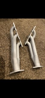

Yes, indeedy. I went with Wildcat headers from BestMufflers.com. They're made by Genie, so I tried to go through Genie directly. With shipping, they would have been about $200 cheaper, but there was a lot of run around trying to communicate with Genie, by the time someone who could help responded, I had already ordered them from BestMufflers. $641 USD landed at my door. (Or at a local post office in this case since I wasn't home.) Not cheap, but I have spent a lot more money on a lot more dumber things. Lol. If they improve the 15 mpg I've been getting, they'll pay for themselves pretty quick, then it'll be like I'm making money from having them, right?

I have these headers on mine. You lose a little bit of low end torque but they rip. You'll need to weld in 02 bungs. I am going to put my butterfly valve's back on to attempt to regain some of the low end torque loss. I ran one cat behind the collector and a Dynamax Turboflow muffer (18") the vehicle sounds great while retaining the stock rear resonator.

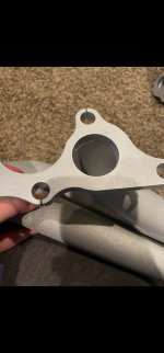

I’m looking at a set of these. How did you address the EGR pipe? In the US market the EGR pipe is on the driver side of a LHD car. From talking to APS it sounds like the EGR Pipe connection is on the opposite side. Thanks for the help!

The EGR pipe is on the passenger side. The Wildcat headers came with the bung already welded on, but not drilled through. Easy enough to drill it, so I guess this is to give you the option of using it or not.

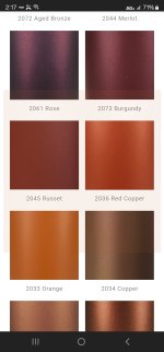

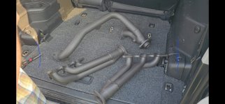

Alright... I need some help. Got my headers back from Jet-Hot for ceramic coating. Here's the color ordered (2036 Red Copper)...Screenshot_20250417_141744_DuckDuckGo.jpgScreenshot_20250417_141813_DuckDuckGo.jpg
...and here is the product received...
Jet-Hot is telling me the color in these pics looks the same to them. What about yall? Notice any difference? Like, I don't know, maybe it being a completely different color?
Seriously though, am I just not seeing this correctly?
EpicPlanet
Update... As frustrated as I was with the color issue, I gotta admit, Jet-Hot’s customer service was absolutely great. Sent them back to be recoated in a different color at no cost. Went with silver since there wasn't any option for red. Turn around time was a couple weeks. They look great!
