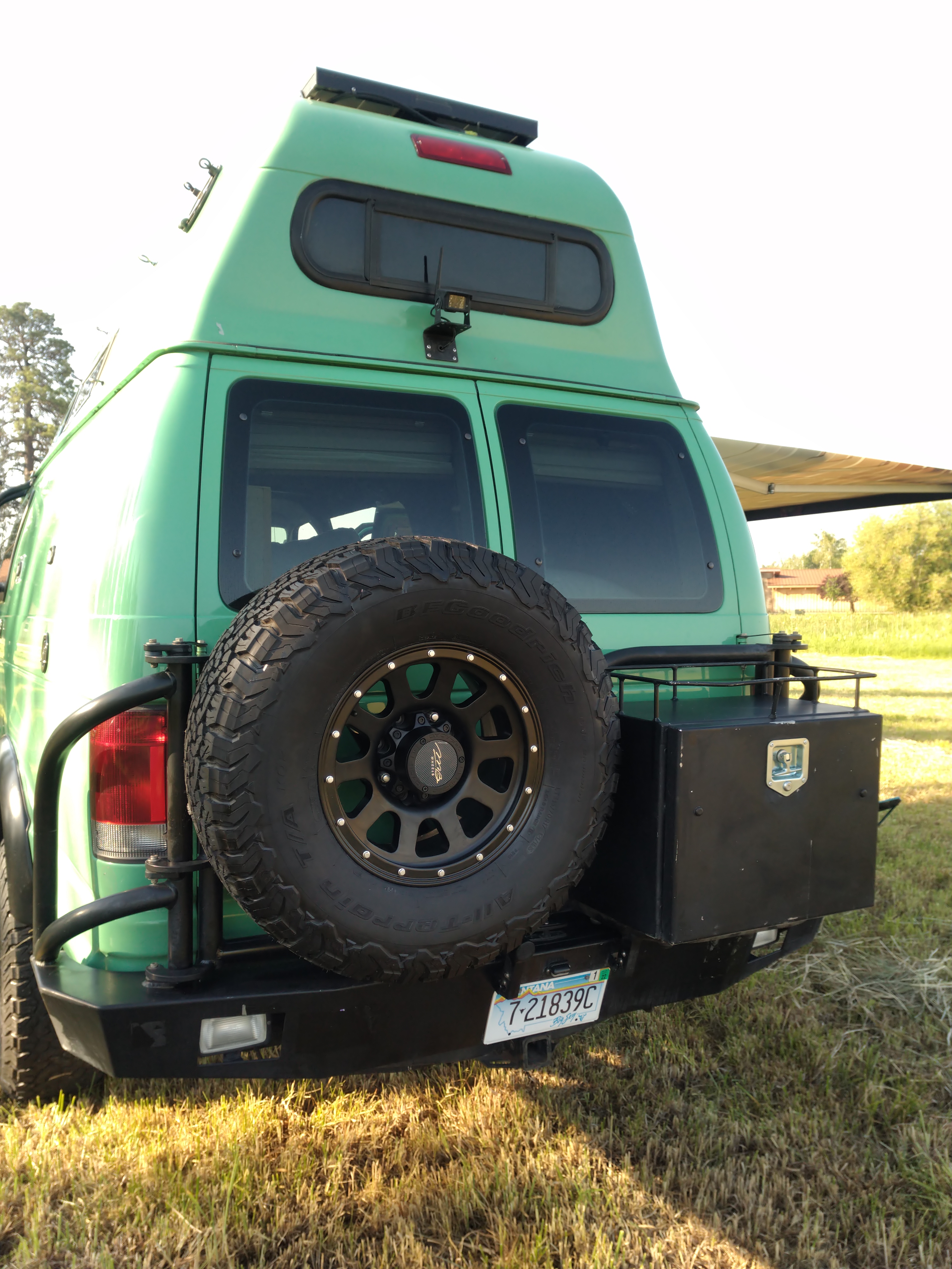

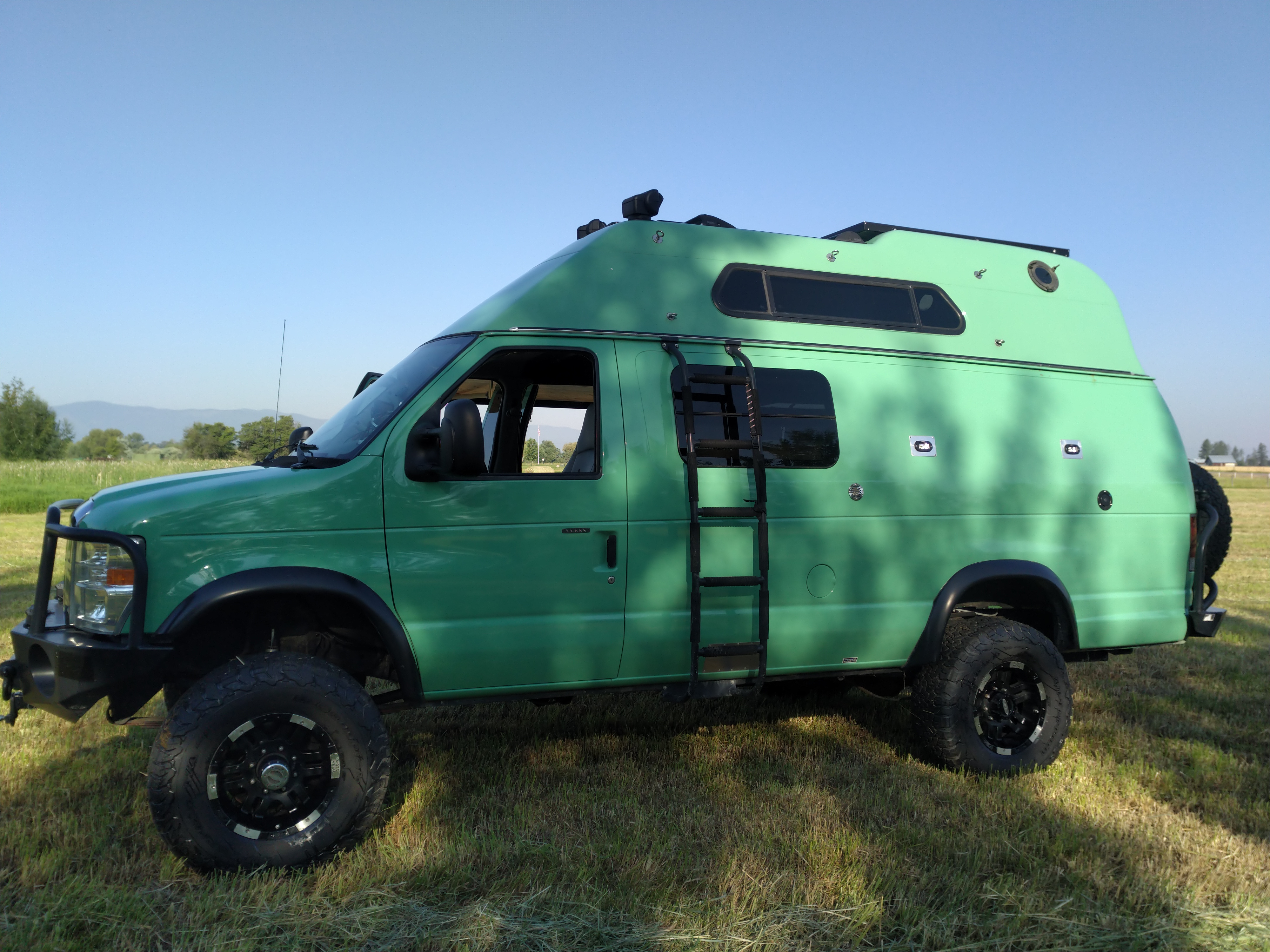

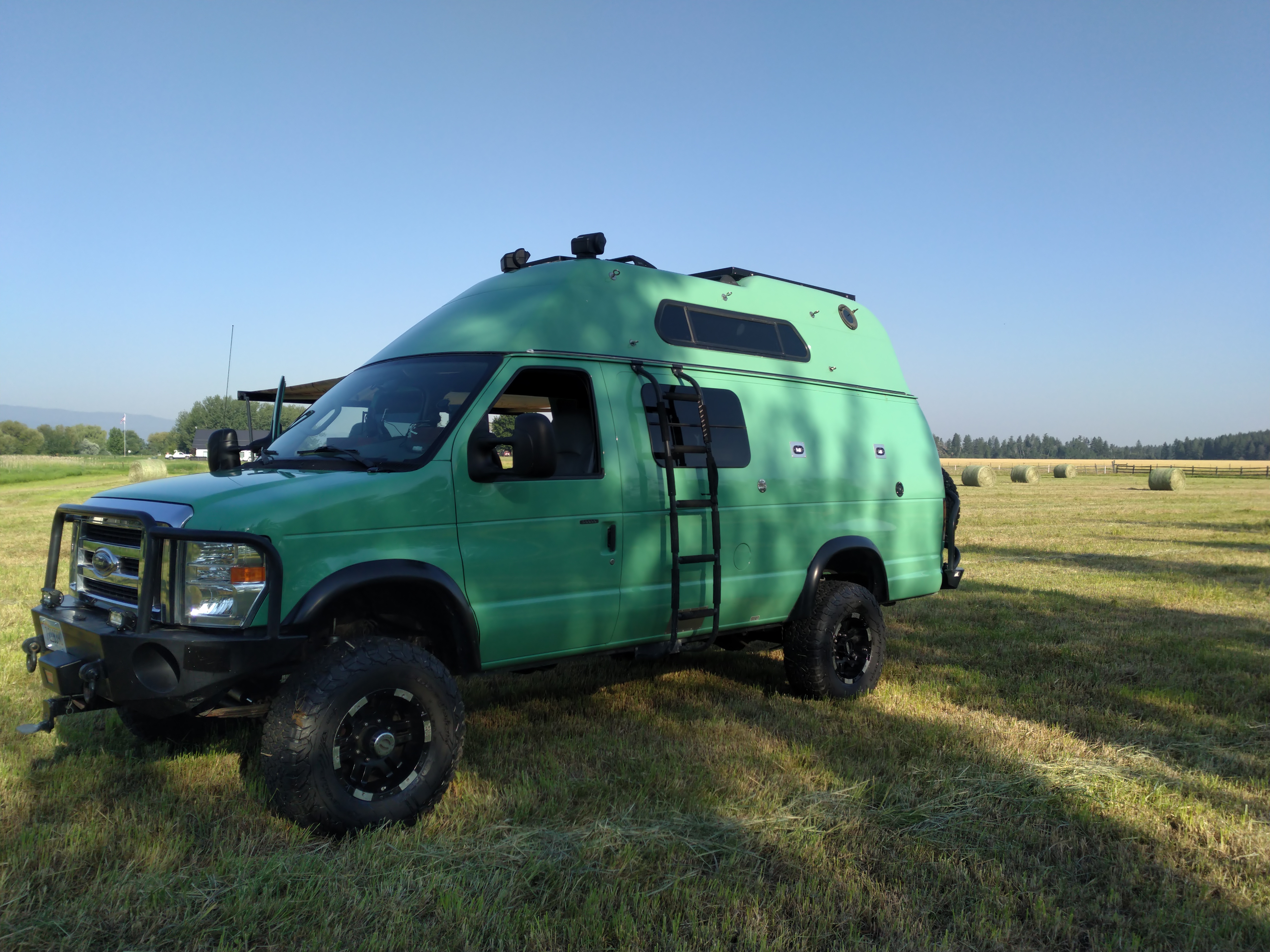

2008 SMB High Top, LWB, Diesel, 50,000 miles.
RTD37
The modifications listed below are what I’ve added to this 2008 high-top Sportsmobile. Everything on this list was a preventative replacement, or modification that enhanced the longevity of the vehicle. I replaced these components based on the common points of failure with the 6.0 PSD, with the intent to build long lasting reliability. We were never left stranded while living out of the van, but there was room for improvement. The current mileage is 49,915, is located in north western Montana, and is parked in a garage, out of the elements when not being used. $95K, photos to follow shortly.
We purchased it from the original owner in 2017, and lived in it for most of the year, with a dog while looking for a place to live. This van seats and sleeps two adults and a couple dogs comfortably. Once we stopped living out of the van, I wanted to rebuild it. Correcting the issues that are common to Sportsmobiles, and the 6.0 PSD mill were the primary reasons. Having a winter project was another motivation, as I enjoy working with machinery. Over the course of the next year, through the Montana winter, this project sprung to life.
We previously owned an Earthcruiser FX, and quickly found the limitations for getting it into tight trails with low tree canopy’s, and also with the Fuso platform in terms of reliability, and performance. About a year after purchase, we sold it, and found this Sportsmobile. Earthcruiser did an excellent job with the house build out. Many of the components in this build were inspired by Earthcruiser’s M/P/E punch list. Panels, marine equipment, water filtration, heating, etc.
The Sportsmobile platform excelled at the things that challenged the Earthcruiser. It was capable of getting into tighter, more challenging terrain. Had true front and rear locking differentials, and could cruise normal highway speeds on grades. It accelerated, shifted, and braked better. The Sportsmobile build quality of everything other than the chassis was less than ideal. The cabinets and millwork were all MDF, it had a tiny fiberglass sink that was difficult to use. The Sportsmobile factory bed was uncomfortable. It utilized a fold down bench seat, and a puzzle of cushions to form the sleeping surface. We value restorative sleep; living on the road full time can be exhausting at times.

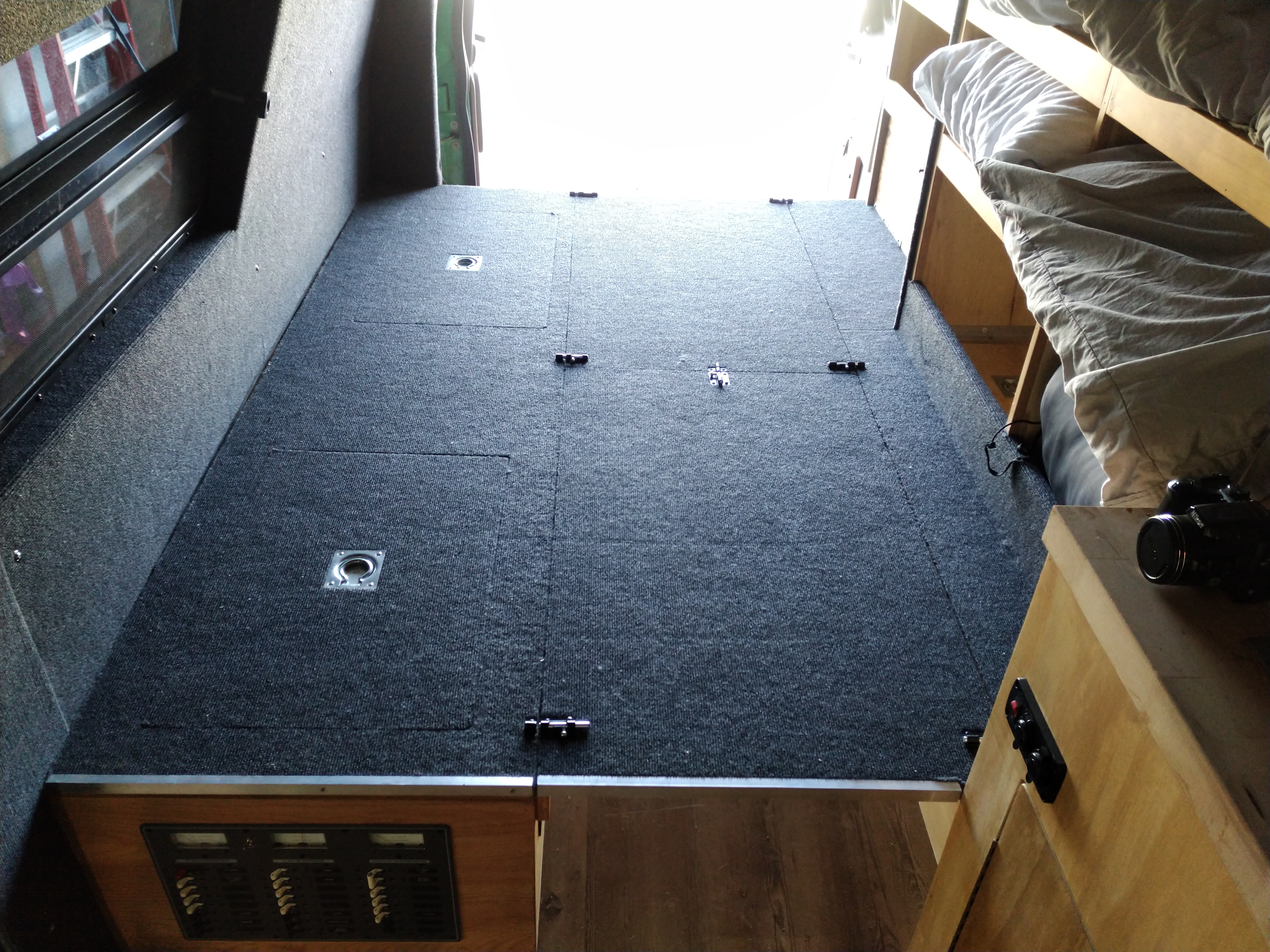

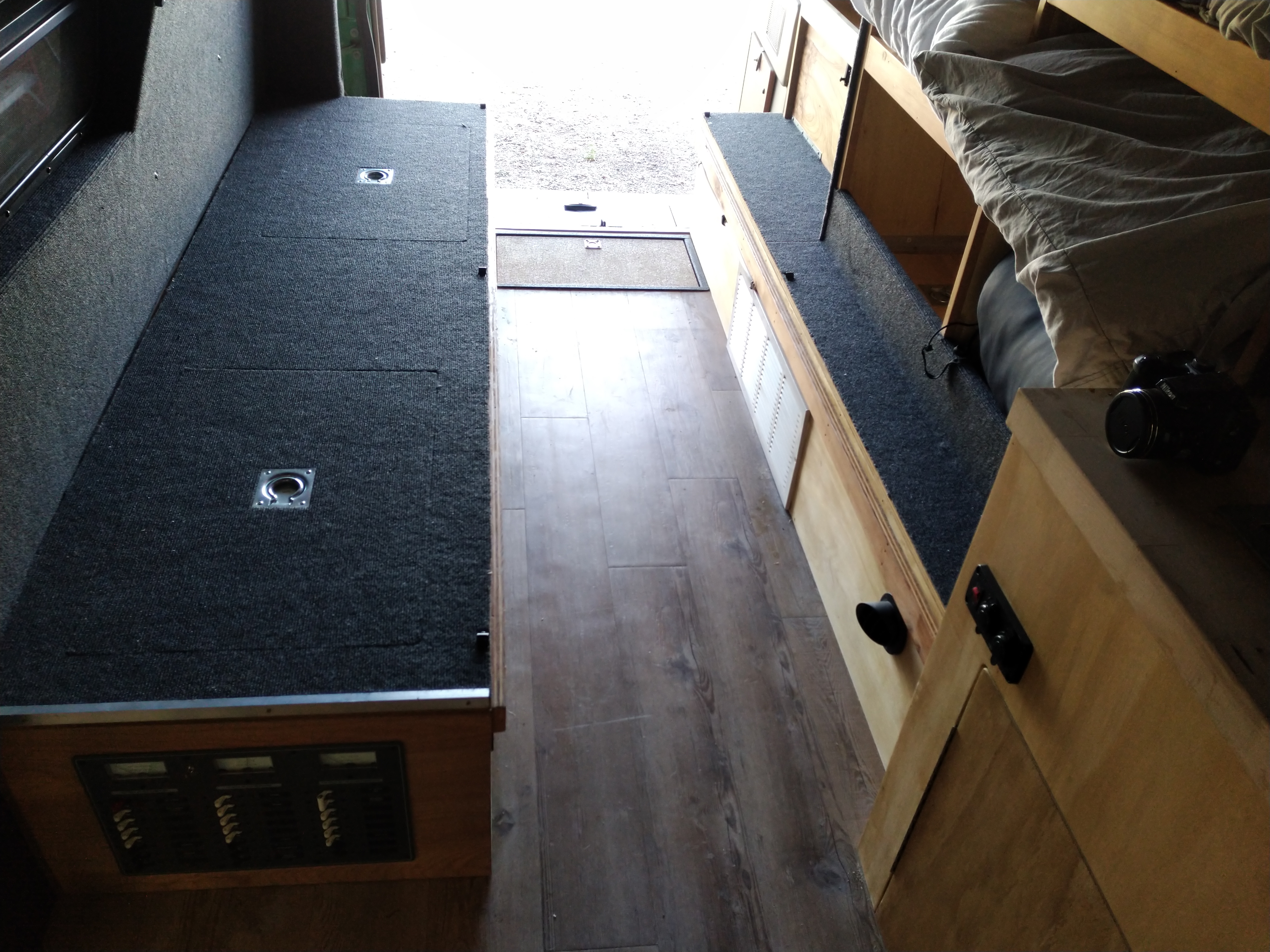

I converted the original floor plan to a dedicated full size mattress (Inofia 73”x52” memory foam with pillow top cover). There was no room under the original seat/ bed to store long cargo such as skis because the inverter, domestic water tank, and seat bracing occupied all of the space.
We wanted to have the ability to haul long cargo should the need arise. The mechanical, electrical, and plumbing now reside by the wheel wells, leaving a center channel to haul skis, lumber, or secure a couple bicycles if needed. The bed platform can be removed to access this space, it and the bed can be stored on a rear shelf above the living area, to the rear in the roof extension.

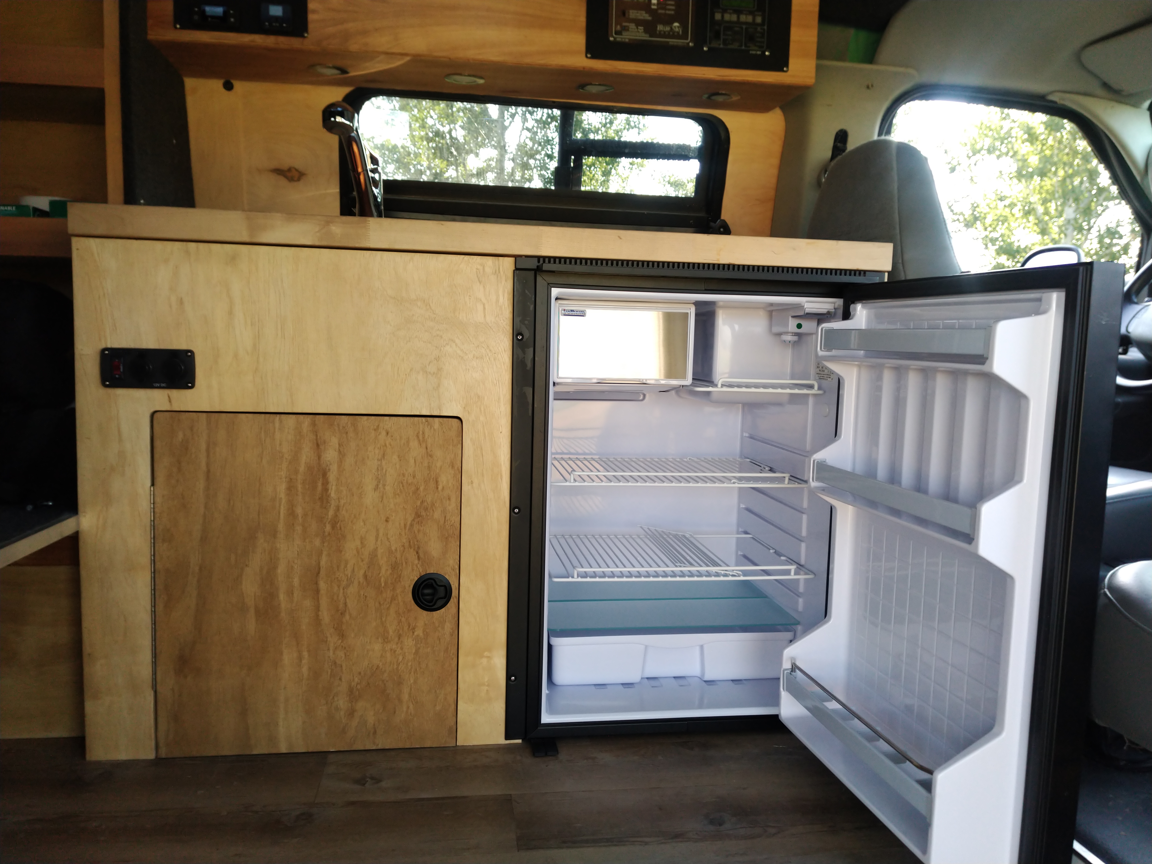

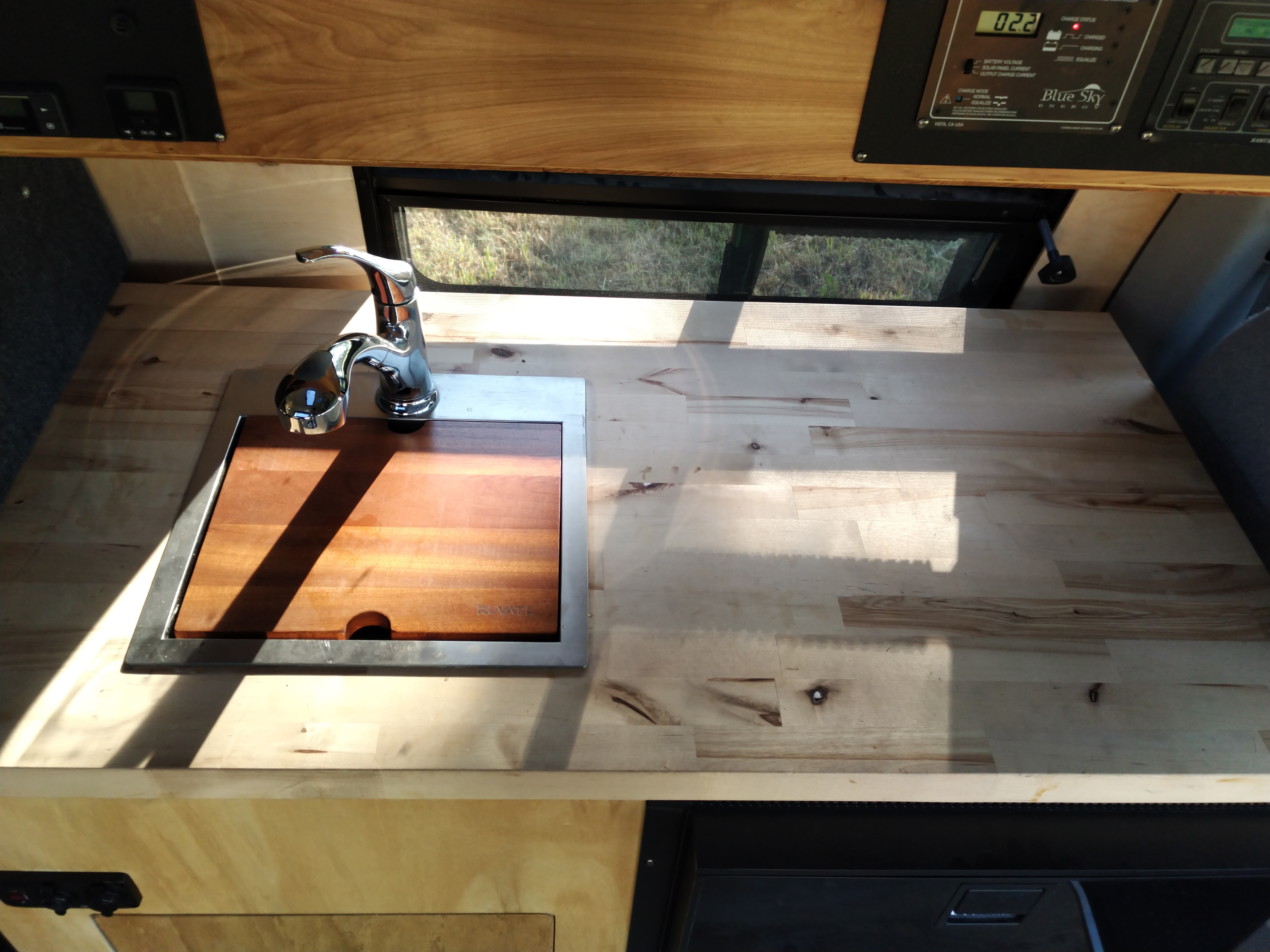

The cabinets are now plywood, with a birch butcher block galley top, and a 15” x15”Ruvati stainless steel deep sink with removable colander, and inset cutting board. There is no on board cook top, we usually cook outside on portable butane burners. This gives more flexibility in cooking, and keeps spatter, smoke and heat down to a minimum.
*Note, when I disassembled Sportsmobile’s original house wiring I was surprised to find no dedicated ground bus. Many grounds were grounded to the body, next to whatever appliance they serviced. I also found several butt splices on long runs of both positive & ground wires.
Sportsmobile used a GE residential breaker panel, Romex AC wiring, and no marine wiring for anything else. I replaced everything with tinned marine grade wiring, breakers, switches, lighting & panels.
All interior lighting has been changed from incandescent to marine grade LED.
Thetford cassette toilet. No shower, we use a portable solar shower bag, and the sink to sponge off. One could easily plumb a shower in, but I found having a dedicated shower unnecessary in a small vehicle. I probably missed something on the list.
We live in quiet rural area in NW Montana, and no longer need this truck for retreating to the woods. I also prefer camping off of a motorcycle or bicycle.

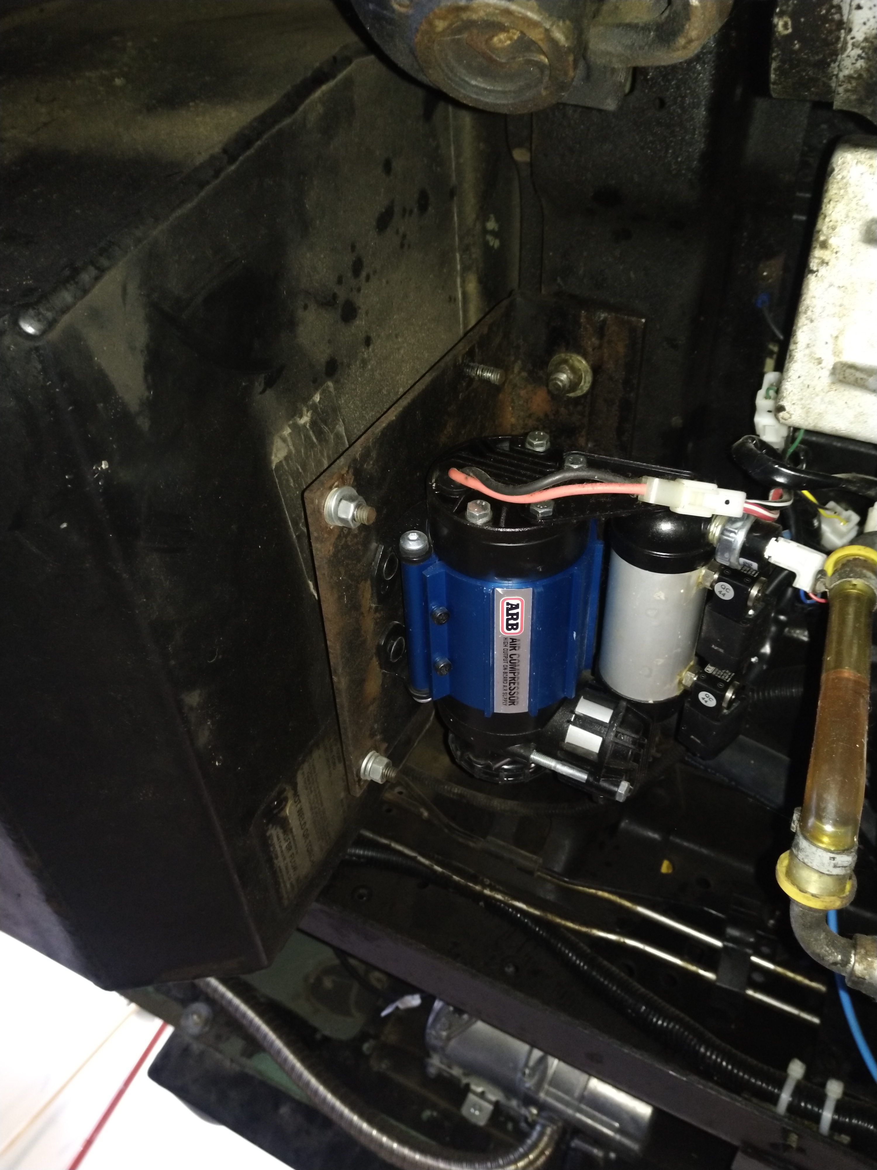

Mean Green 6675 6.4 high torque starter.

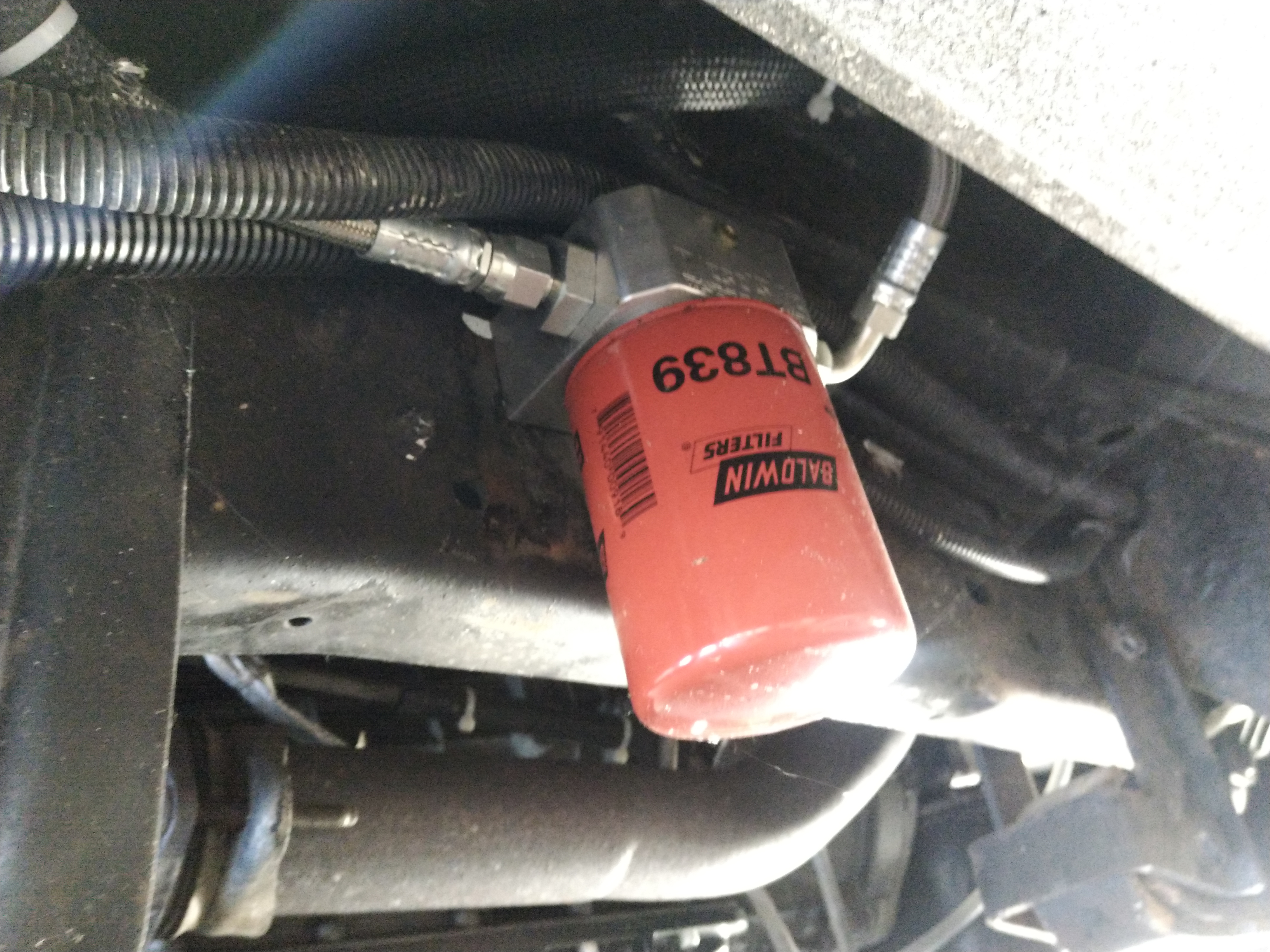

Diesel Site remote transmission filter. Protects the transmission in the case of a torque converter failure by catching the debris before it can make it back to the transmission.
No need to drop the pan for filter changes, the OEM filter will only require changing approximately every 100,000 miles.
The fluid in pan stays clean, protecting the transmission from debris, filter canister acts as a small heat exchanger, bypass valve allows fluid flow if the filter plugs with debris, spin on filter replacements are less expensive than the OEM style.

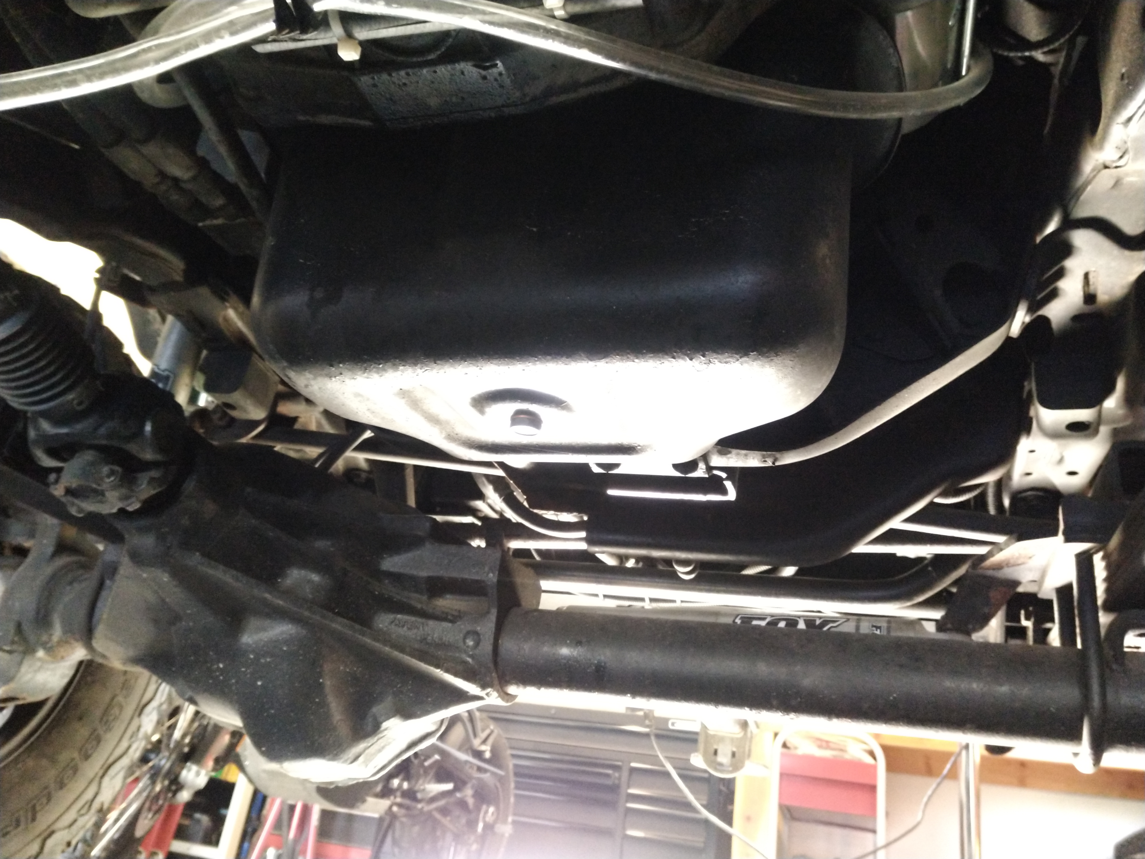

Mag-Hytec deep 16q transmission pan with 6.4 filter.

Five 315/70/17 BFG AT K02 E load range, approximately 2500 miles on them.
Existing equipment:
Amsoil dual bypass oil filter

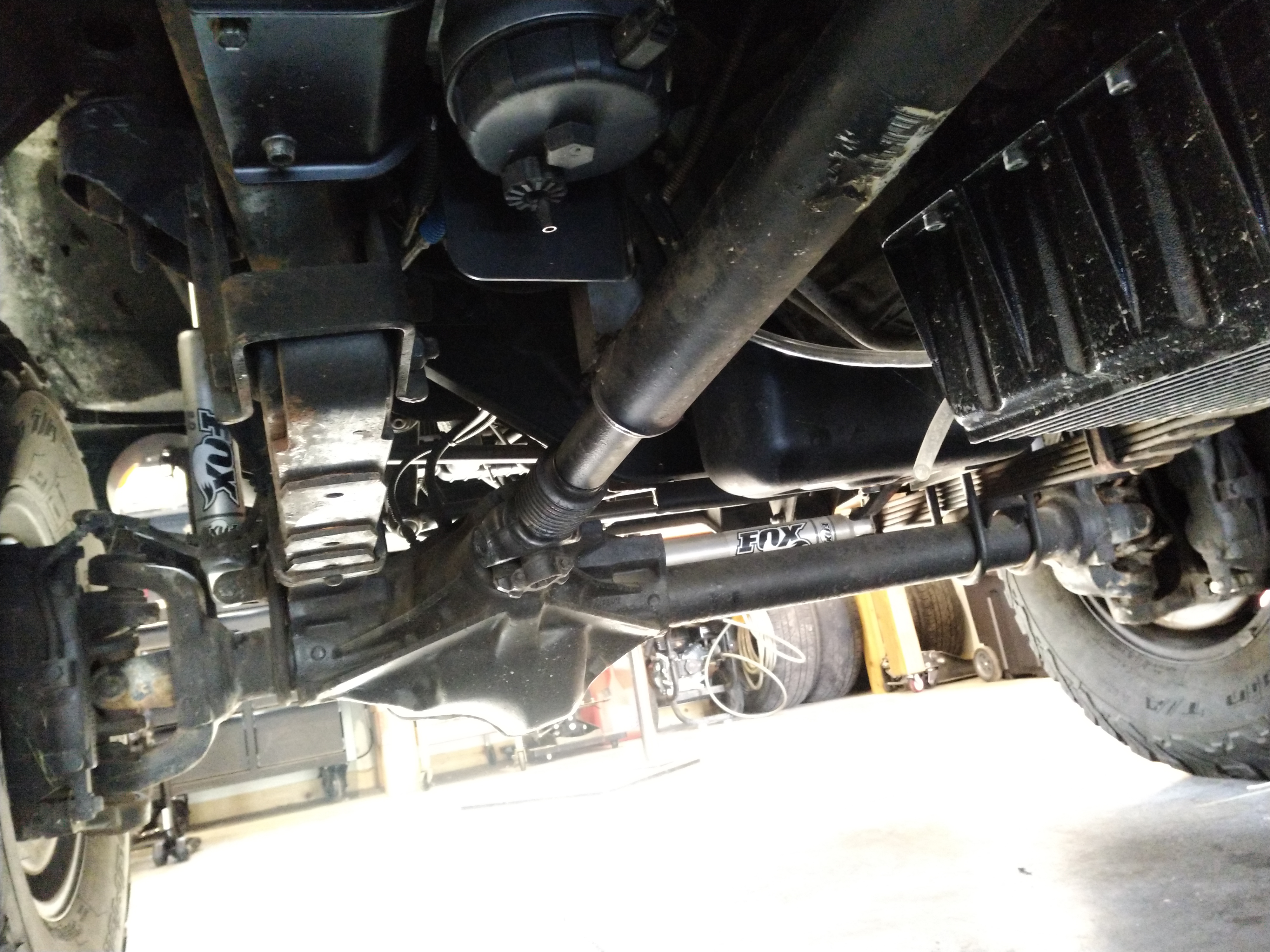

Advanced Adapters Atlas II, 2 speed transfer case.
46 gallon transfer flow fuel tank.
Dynatrack 60 full floating rear axle.
Dynatrack 60 front axle, warn hubs.
ARB lockers front & rear, with new compressor.
Aluminess bumpers, tire carrier & storage box.
Warn 12.5k winch.

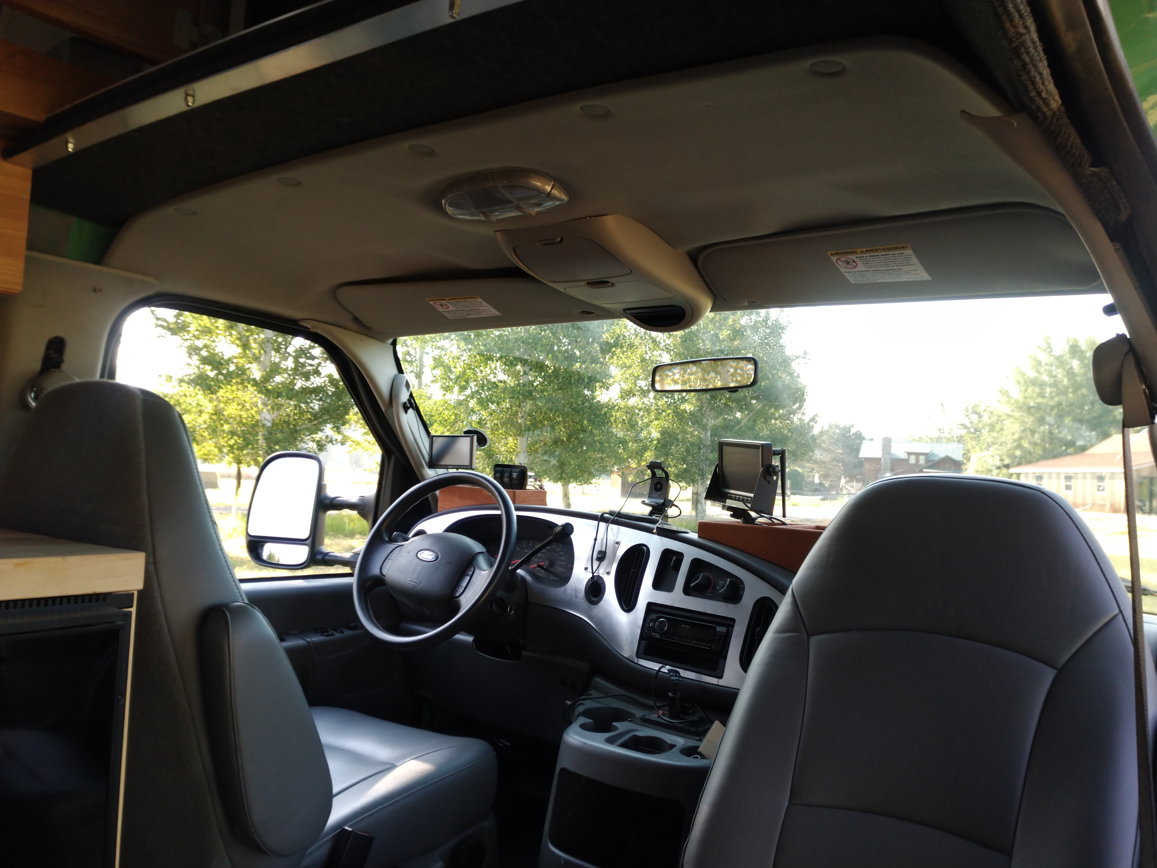

Cab:

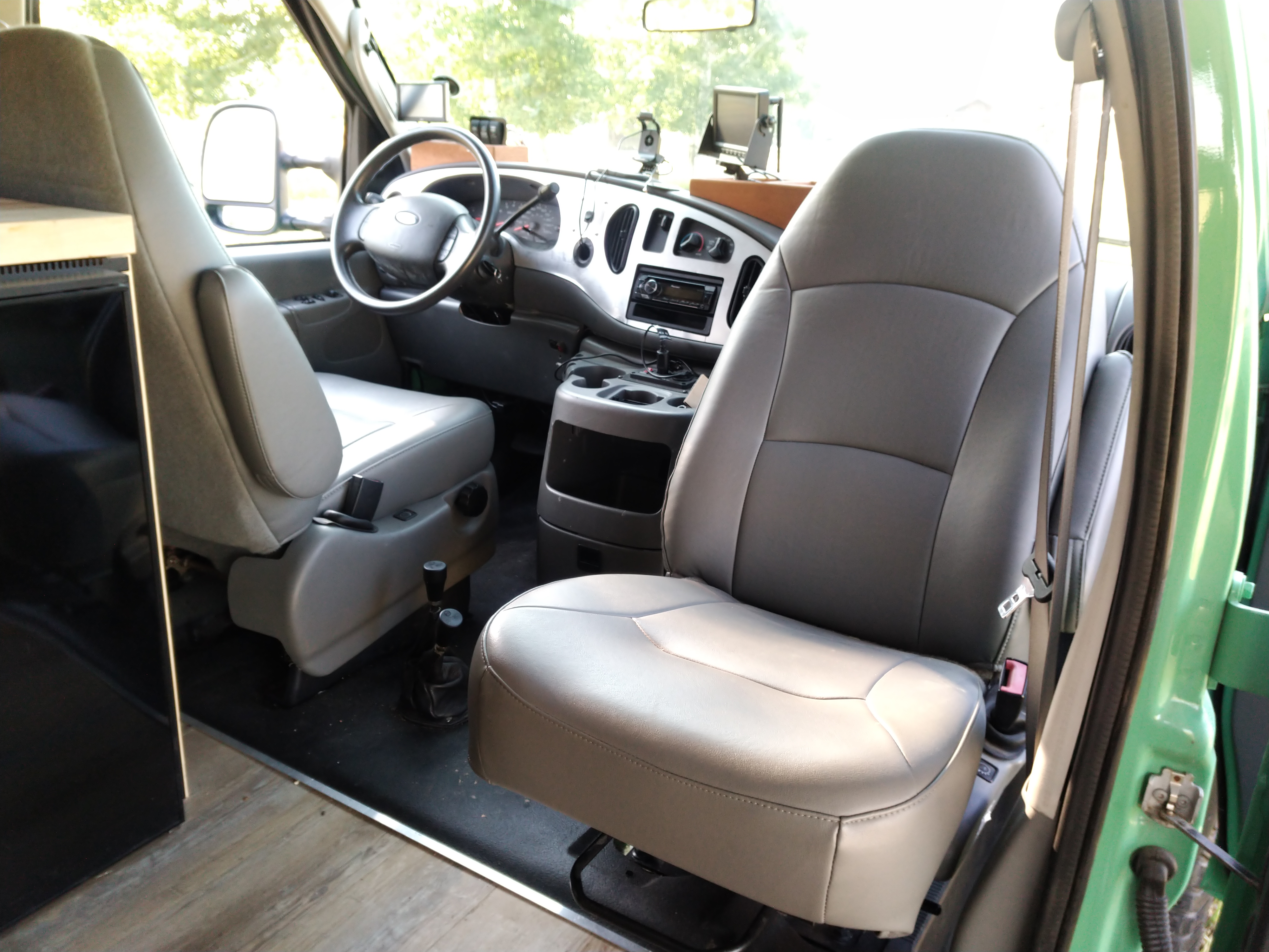

New OEM headliner & sun visors
New seat foam, & OEM covers.
New OEM molded rubber floor mat.

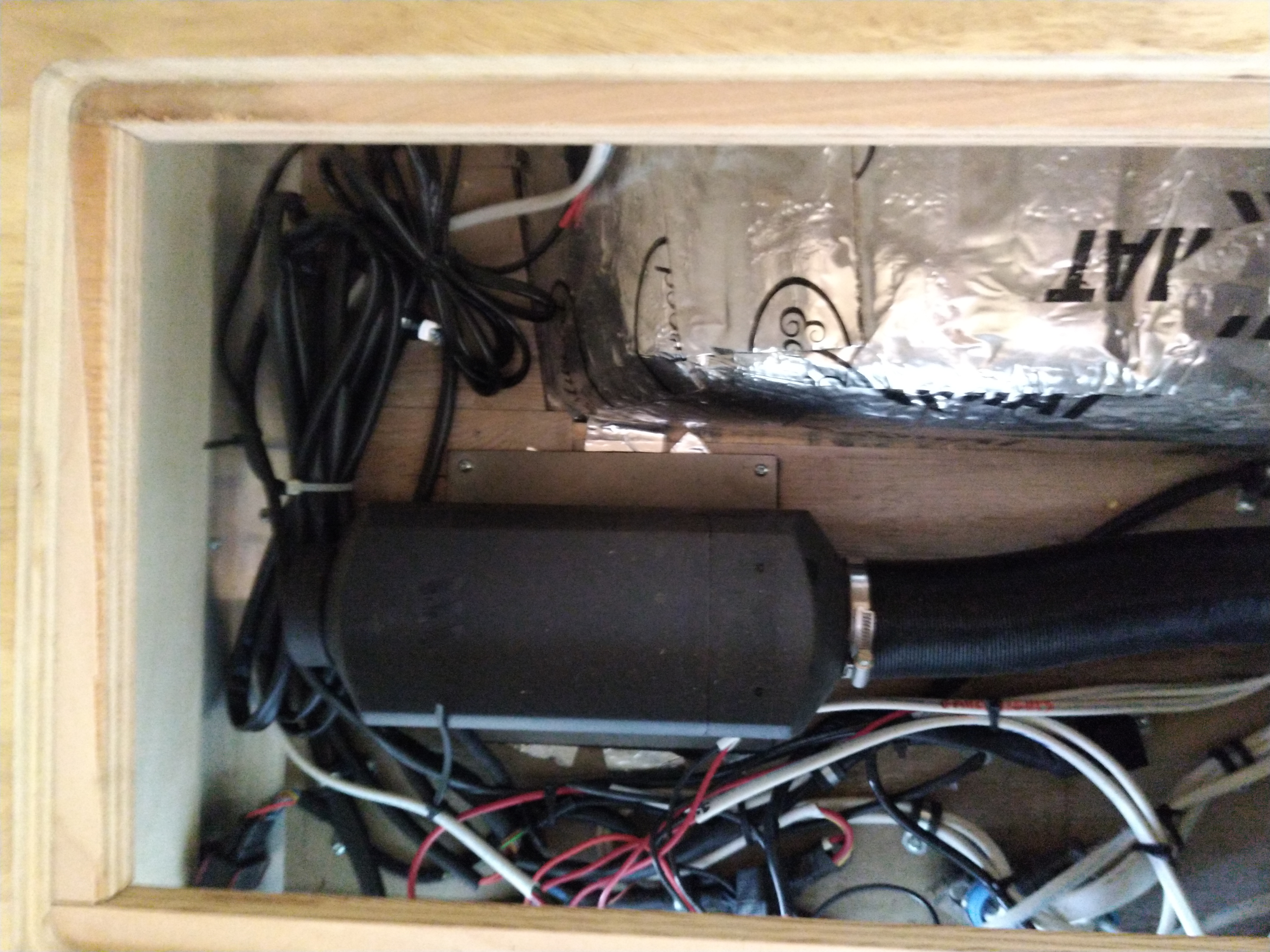

Eastwood X-Mat Aluminized rubber sound & heat barrier.
Eastwood spray on heat & sound barrier coating.

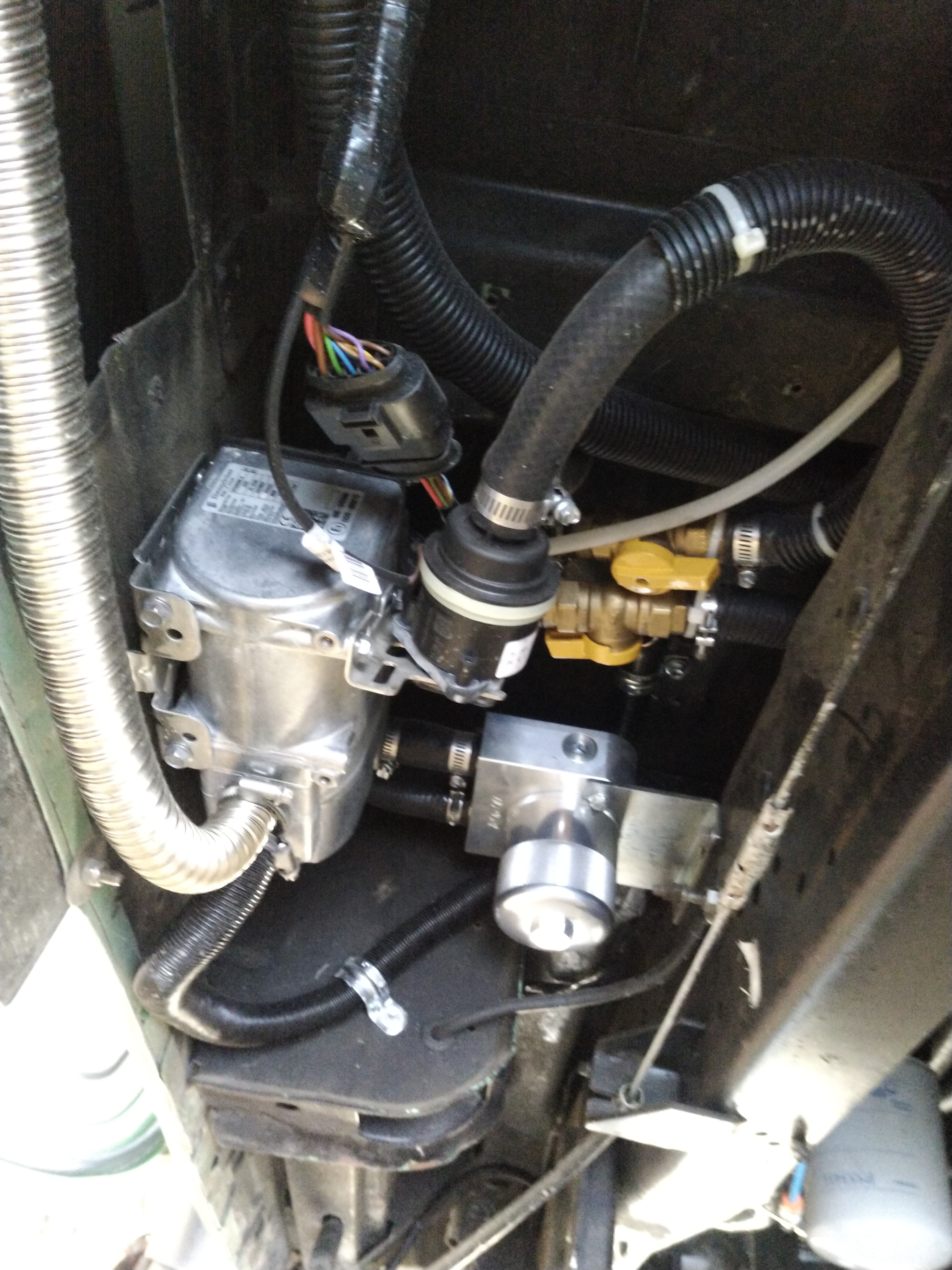

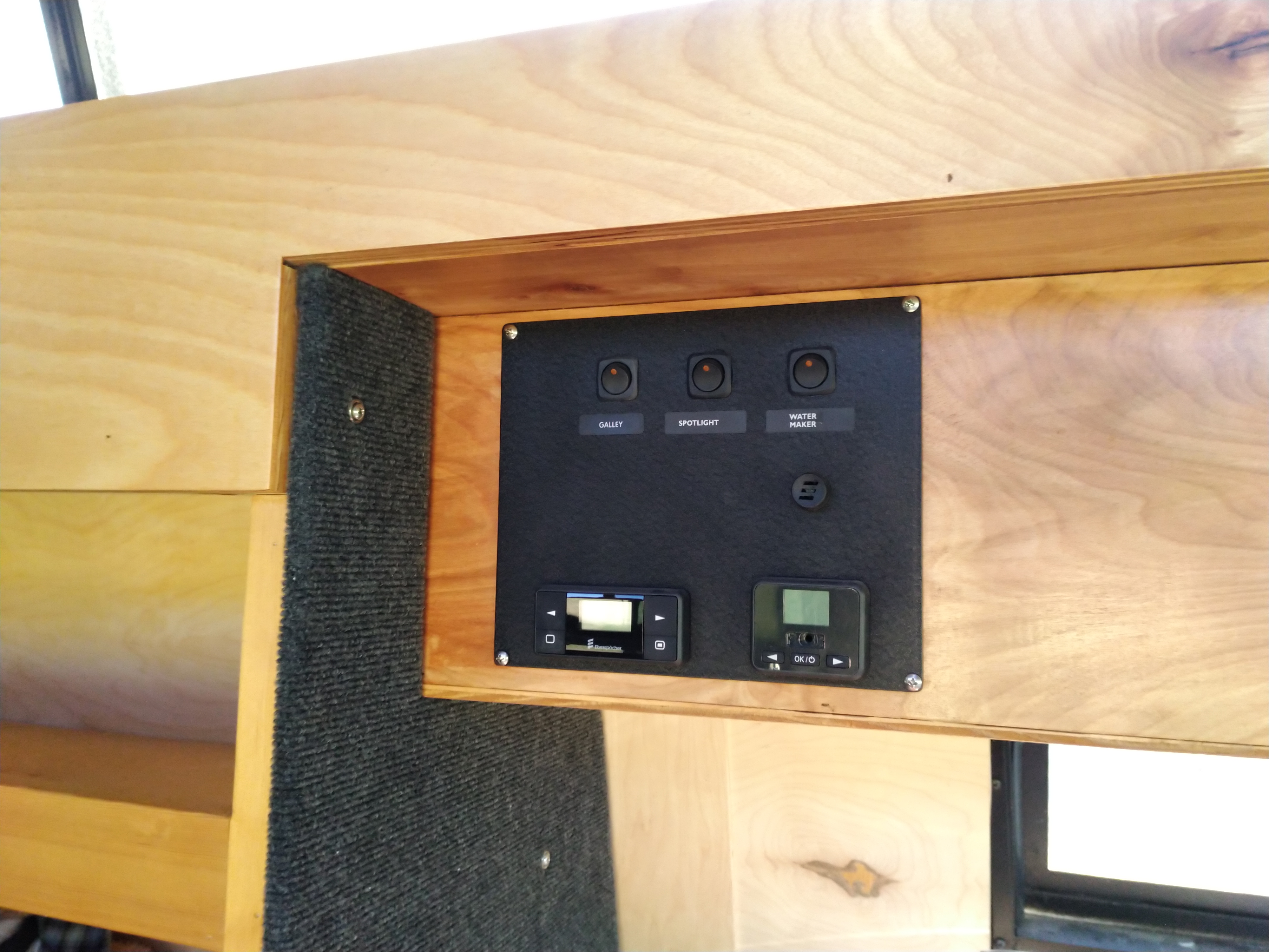

New Espar Airtronic D2 diesel cabin heater.
New Espar Hydronic D5 diesel coolant heater.
New silicon coolant hoses.
New AIC brazed flat plate heat exchanger. The original heat exchanger was mounted under the chassis leaving it exposed to debris, and freezing temps. It is now mounted in the cabin.

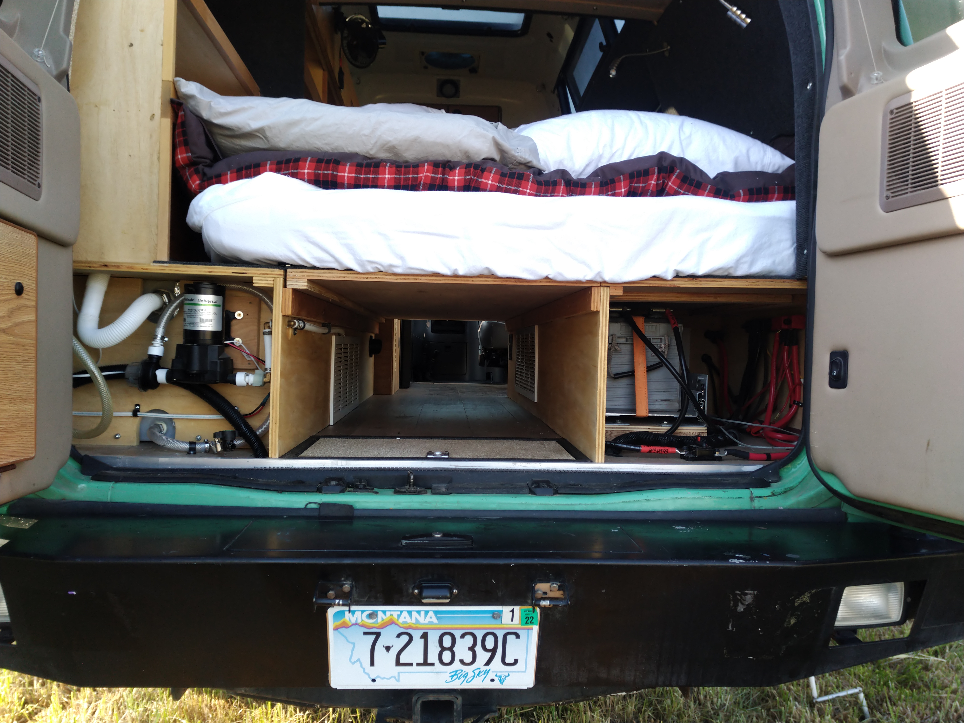

New 24 gallon fresh water tank. The original tank was 12 gallons.
8 gallon grey water tank, with new gate valve.
New Whale 2gpm fresh water pump.
New Seagull IV X-1 water purification filter (cold side).
New Shurflow accumulator tank.

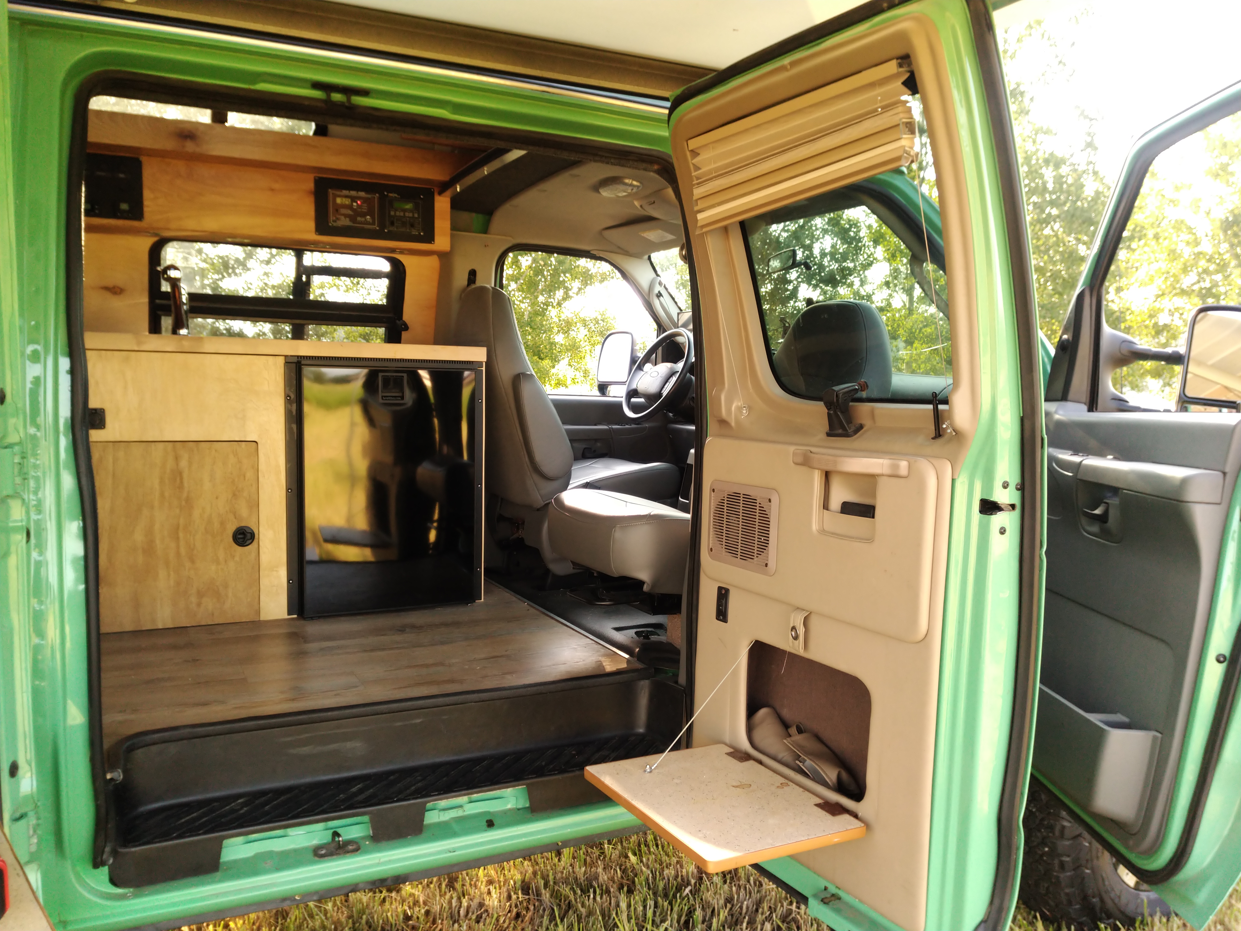

New Isotherm Cruise 130 Elegance 4.6 cubic feet marine refrigerator.

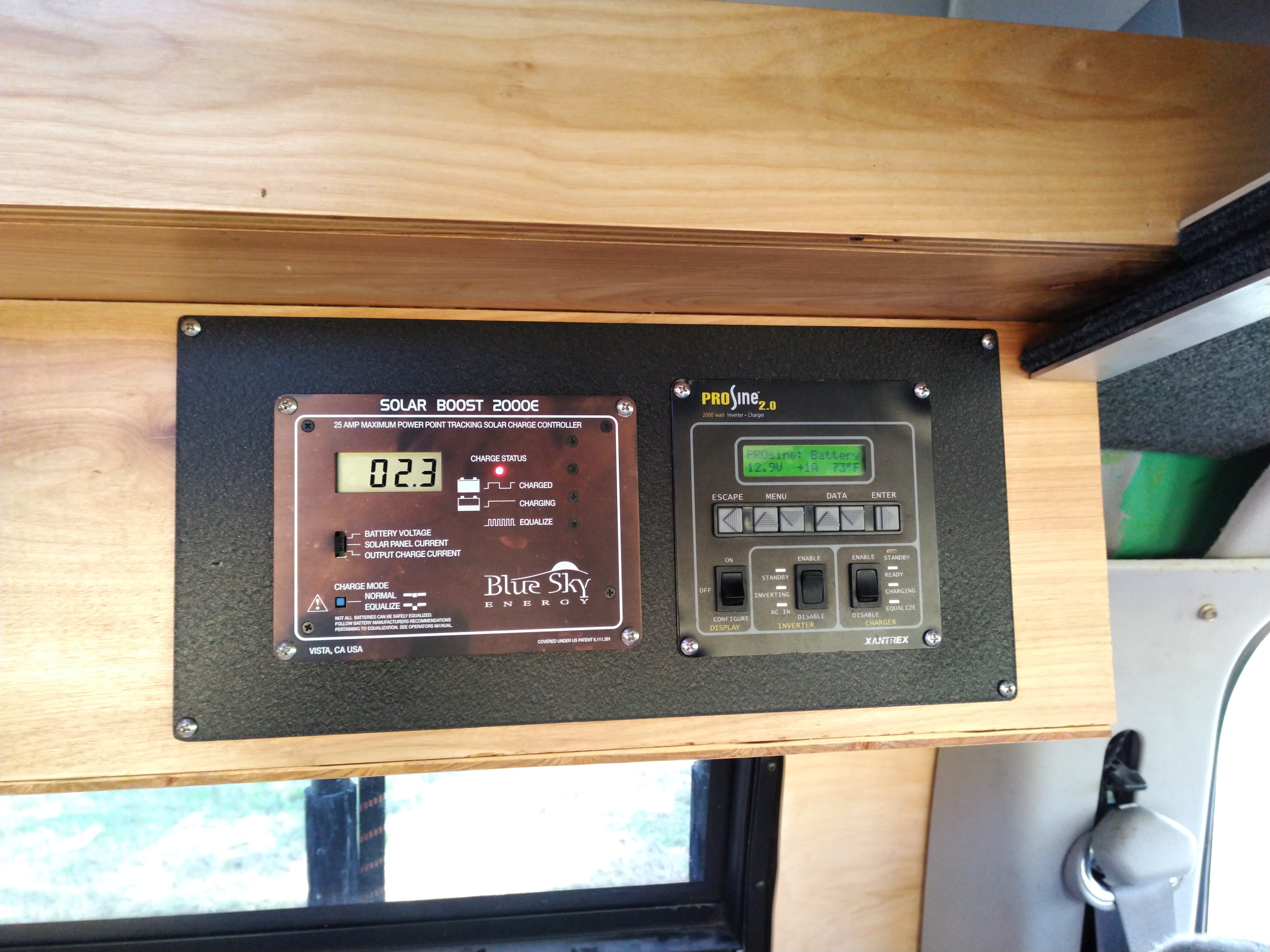

Existing Xantrex Prosine 2.0 inverter.
Existing Blue Sky Solar Boost 2000E controller.

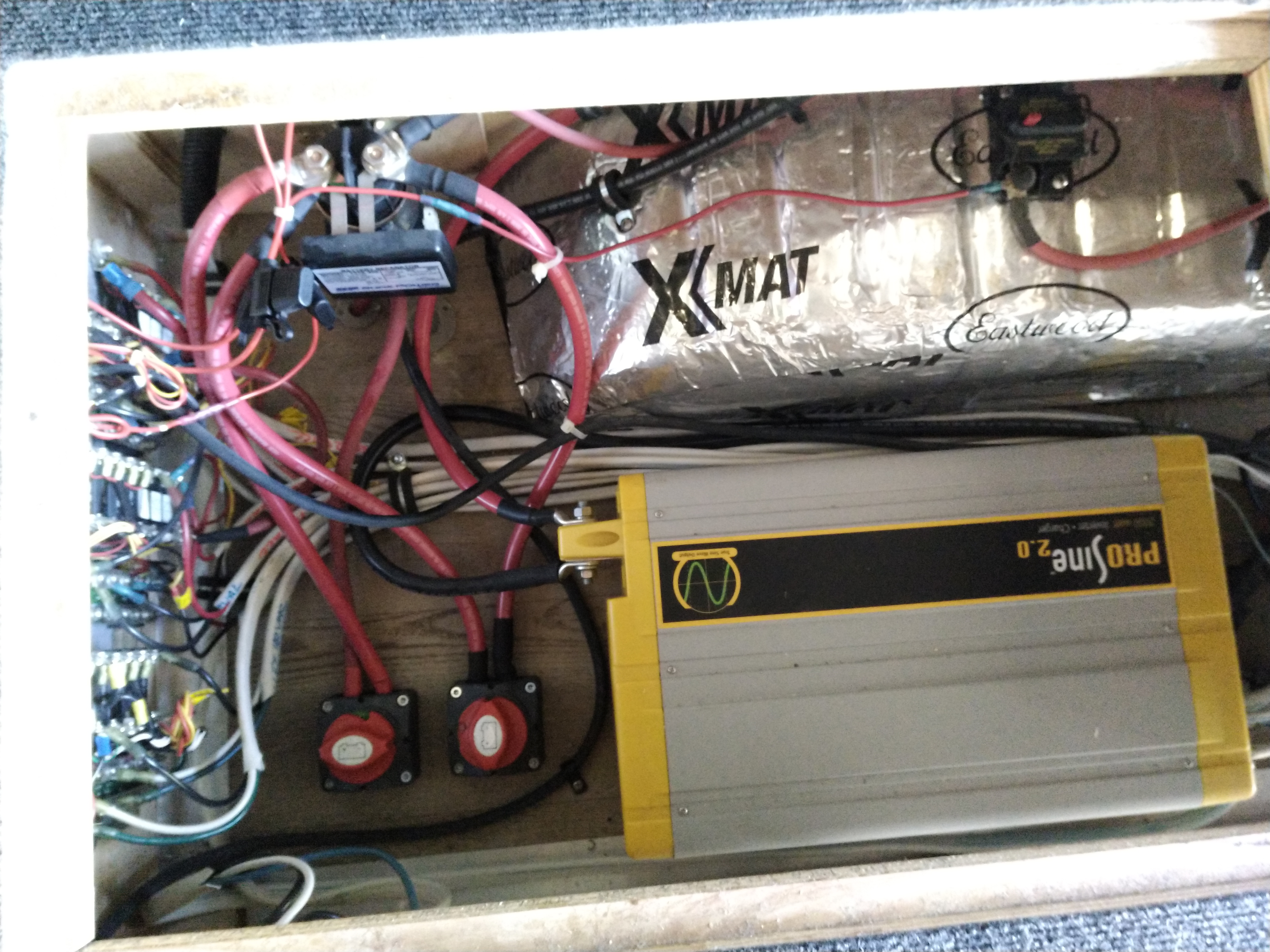

Electrical

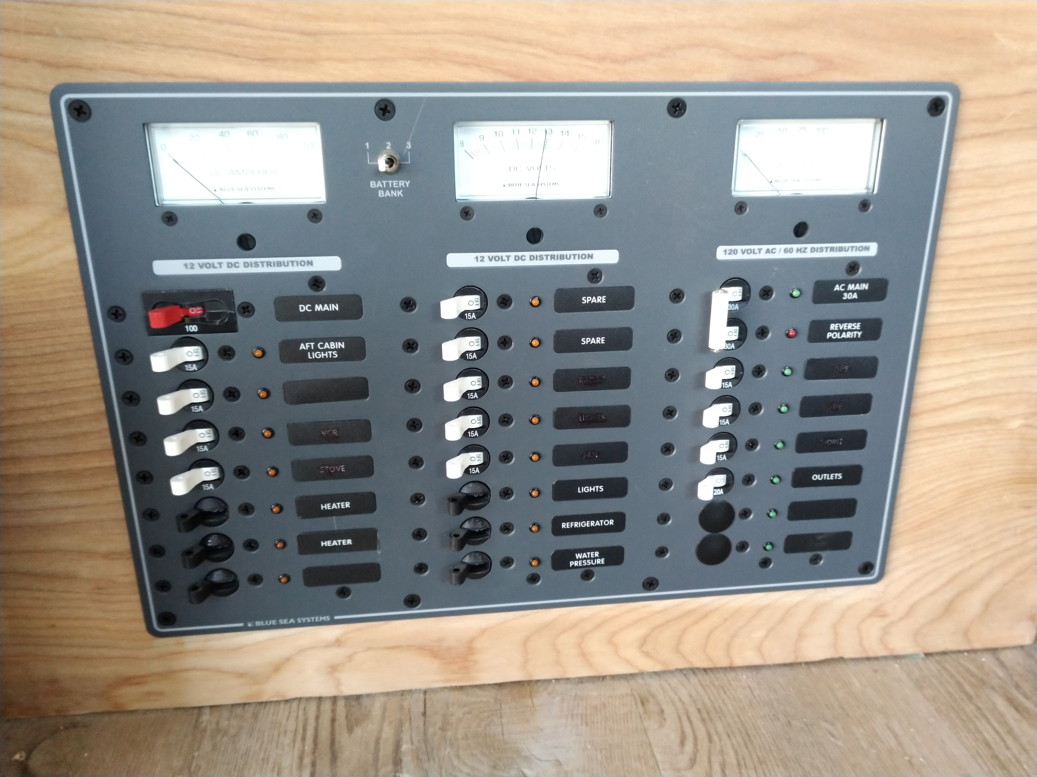

New Blue Sea marine AC/DC panel with room for expansion.
New Blue Sea marine fused sub panel.
8D AGM house battery, mounted on a pull out tray. Now able to be serviced by a single person.
New Sure Power battery isolator.
Manual switch to link house & engine battery failsafe.
30 AMP shore power with dedicated marine breaker.
All wiring is tinned marine grade.
3 switched Blue Sea 12v & USB outlets.
1 15Amp 120VAC outlet.
All terminals are marine grade with heat shrink insulators.
Grounds run to dedicated bus on sub panel or main panel.
There are no body grounds.
All positive feeds are home run to panel, no splices.
