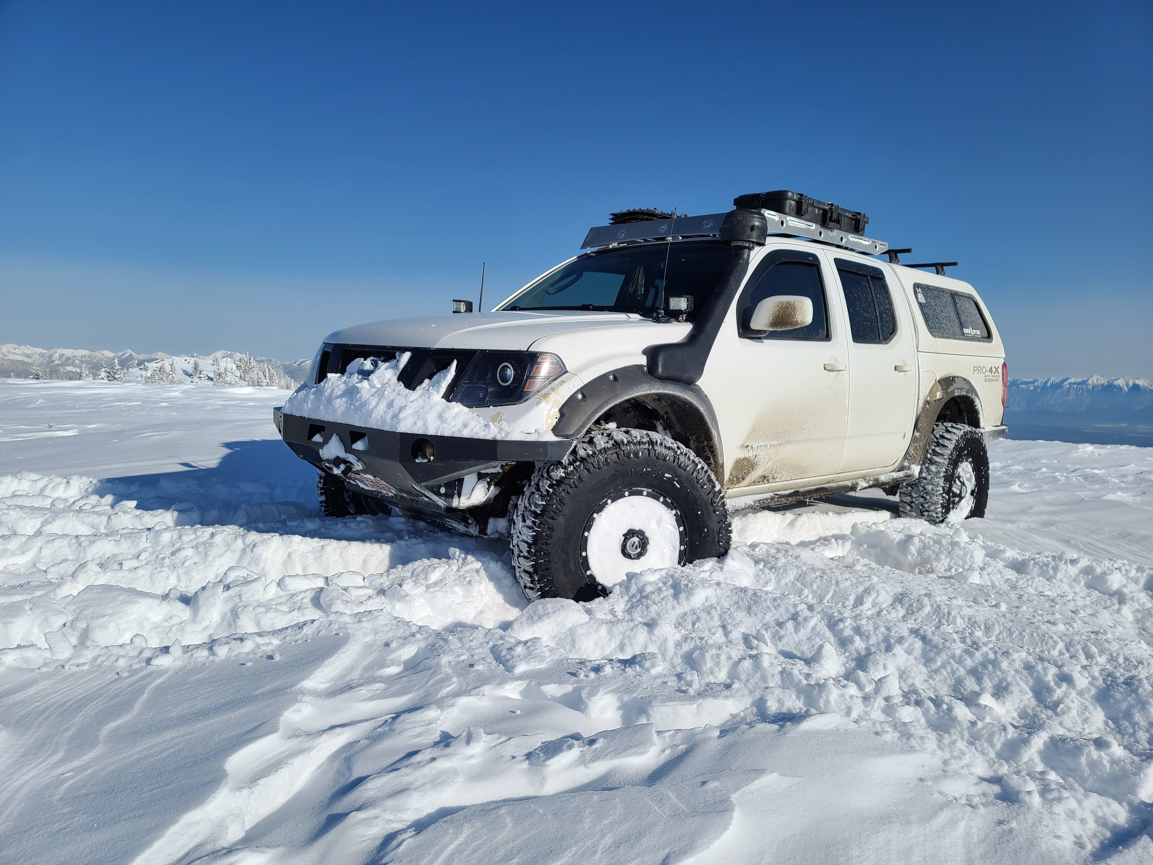

Doing a bit of post winter update on the truck,
Lately I was really noticing a big drop in fuel mileage and power, especially on long hills the truck would hesitate to down shift and really try to lug it out up the hills, I'd have to almost give it full throttle before it would actually downshift, it got to the point where I would drive around with the over drive off to help keep the revs up. With no codes to go off to point me in a direction to take the diagnostics I was getting frustrated. Everything I was checking seemed to be operating as it should, I was getting closed loop in the o2 sensors, they were responding to load as they should in the live data, cleaned the MAF no change, Replaced the MAF, no change.
I saw the Z1 High output Ignition Coils and noticed they were on sale so I just grabbed them along with the IMS since you have to remove it anyways to do the coils.
Holy crap what a difference, it downshifts as it should, way punchier off the line and after it really pulls hard between 3-4k RPM, and best of all my fuel mileage on the display went from reading 22L per hundred Kilometers to 14.9L. I will do a drive out to the coast this weekend to really calculate it myself but I'm very pleased with the coils and IMS from an ass in the seat feel alone.
And heres more of what everyone wants to see anyways

I almost have 1000k on these now and the real world fuel mileage is up to 18L but that's mostly aired down and like 90% off road, the first run up was flat highway, it's still almost 5L difference in fuel mileage and my power way better.
