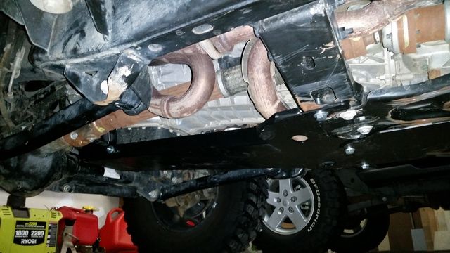

1. MORE Engine/Transmission and Transfer Case skids are installed..,yes, my stock cross member has taken a beating, but my Jeep gets a lot of use in all kinds of terrain, including rock crawling, so I view the skid plates and cross member as disposable items. When they get too beat up, I'll replace them.
