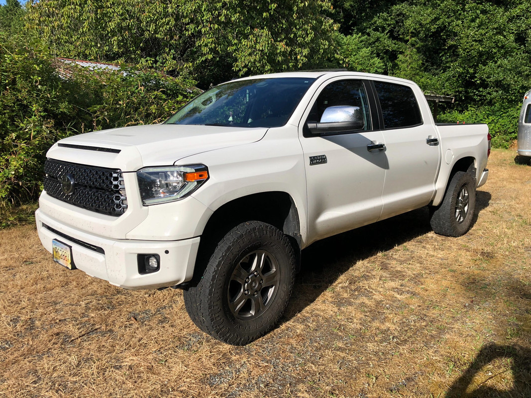

Well, that’s what I experienced too! I ended up getting the ‘19 and found it has Bilstein 5100s in the front, but on the lower setting, so I popped them out and put them in the 2.5” position, and put a 1.5” lift and Timbrens in the rear. It’s currently on 35-12.50s on factory Sequoia wheels with 1.25” spacers, but I found a deal on a set of Fuel wheels in the correct offset for my 35s. Thanks for all the input. I’m really liking the truck! I did find a 2014 as well, with only 25,000 on it, but it was too old for the lease I need. Mine just turned 60,000.
RedSun

I bought the Fuel wheels with 35” Toyos on them, but the seller was a lying jerk. He said he had no rub and that they only put the tires 1/2” or so outside the fenders on his Tundra. On mine (same amount of lift) the rub is heinous and they poke over 1”, closing in on 1.5”.
My wife hit black ice doing 60 and hit a tree with the p-side of the truck. She was unhurt, and the truck wasn’t too bad, but when pulling it out, the tow guy managed to hook the front bumper on a wire fence and messed it up. Insurance will cover all the damages, and it sounds like I can buy a proper bumper instead of just getting more plastic. I’m looking at the Coastal bumper, but thinking of getting the full tubing they offer. There are tons of deer hit where I live, so full coverage is a must. I love the look of yours, and hope the full tubing can be made to look good too.
Is there enough clearance to keep the bars away from the body? When you built it, could you have spaced the bumper a bit further out from the mounting plate?
