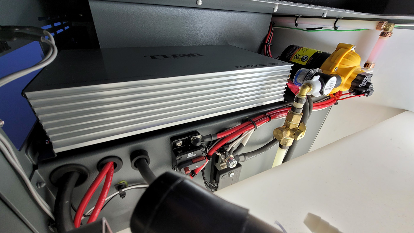

I completed the inverter install via the REDARC Sensor/Shunt (rated @ 300 amps). I chose the Thor 2000-Watt DC Inverter Kit-2 (THPW2000-KIT2) which comes with 1/0 cables, a fuse, and an On/Off remote switch. The dimension of the unit are 16.92L x 8.5W x 3.34H, which is a tight squeeze, but fits perfectly into the space above the battery.
There's still enough room to put the water tank fill and vent hoses back on above the inverter. I haven't selected a spot yet for the outlet and the remote switch. I'll probable put it in the rear where the access door is for the REDARC display and light switches.
Very slick! Will you also leave the inverter panel off allow for access to that 120v outlet and the face of the inverter? Do you predict cooling will be adequate with cover plate on? Looks like the fridge lower vent is nearby so imagine the inverter heat will be drawn up and out the top fridge vent along with the fridge heat.
Regarding wiring the 120v circuit to an rear service panel, I assume that will be strand wire not only because it handles vibration better compared to solid copper/romex but to accommodate opening/closing the service panel? Or were you thinking the outlet and remote switch would not be on the face of the swing-down service panel but off to the side on the aluminum cabinet itself? Countertop outlet might be another option.

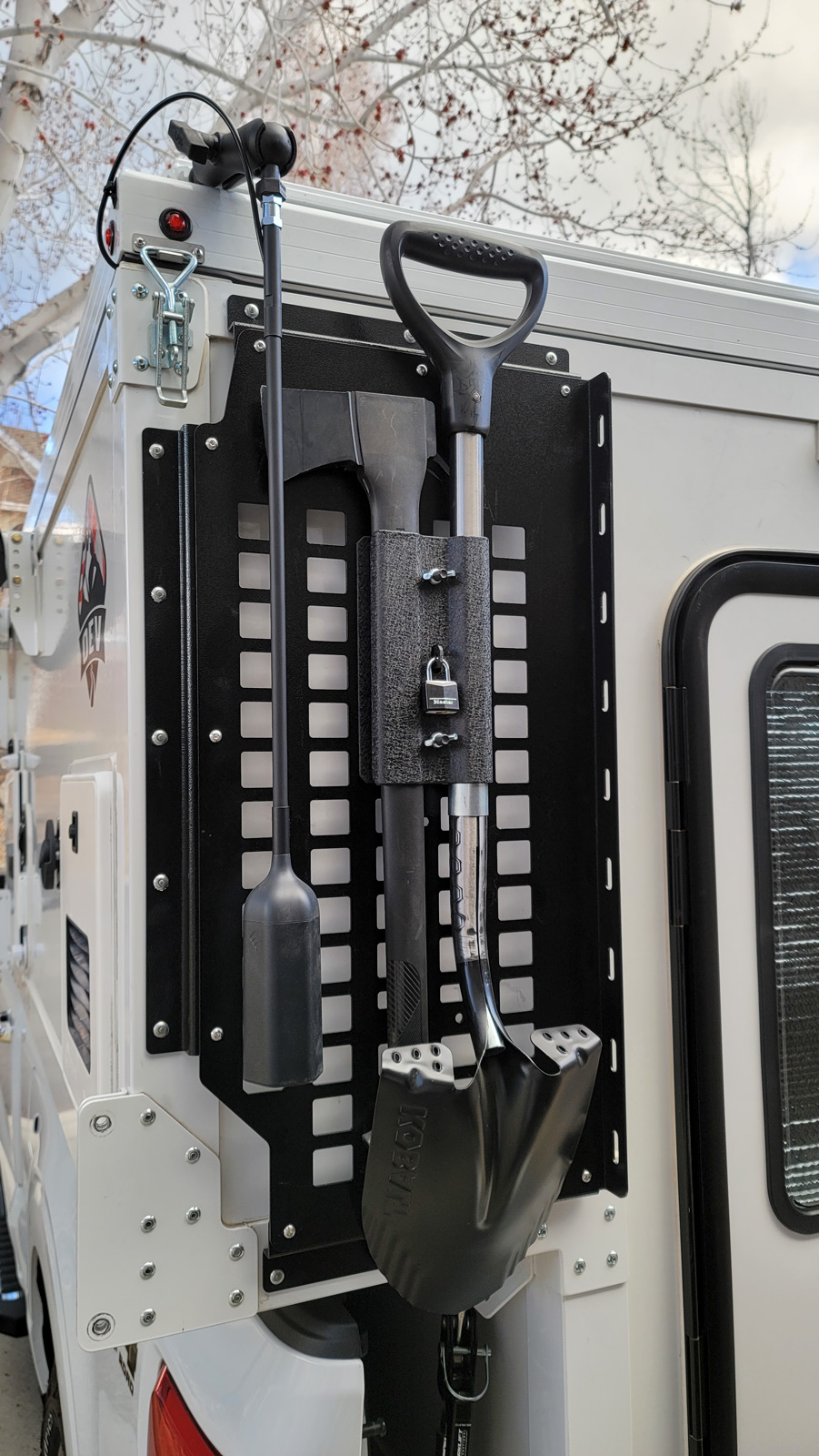

It's been kind of quiet here so I though I would share some recent additions. My 2022 CAMP-X didn't have the left side molle panel, so I had it installed last week.

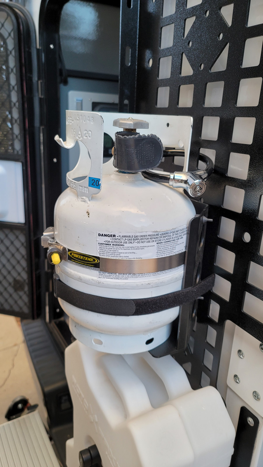

Next up, the Power Tank Propane Tank Bracket. This is a nice unit, I did have to cut some aluminum bar stock to mount it.
Followed by the Smittybilt Axe And Shovel Mount It looks nice and works, but the whole reason I bough it was because of the lock feature. It's really difficult to find a lock that will fit it as the lock tab is too short. As with the Power Tank, I had to cut some aluminum stock to mount it. You can decide which tool is better to drop on your head when you're trying to use it, the design is pretty bad.

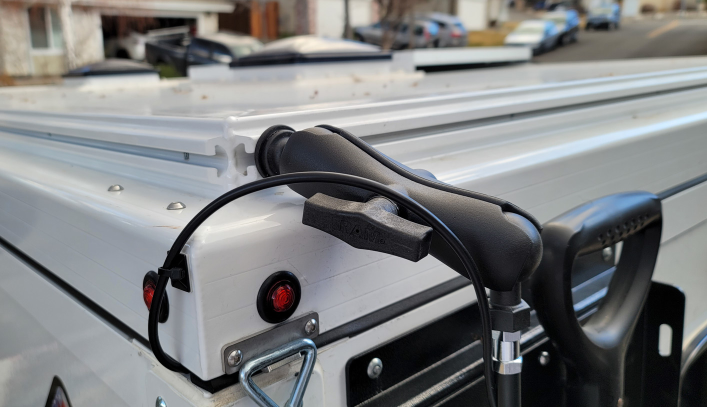

Last up is the RAM Track Ball Heavy Duty Mount for the weBoost. This makes the mounting of the weBoost antenna really easy, very happy with it. That said, the weBoost is pretty much as lame as it's always been. The Cel-Fi Go is far superior to the weBoost. I purchased both last year for our Surveyor trailer and ended up never using the weBoost. Only installed it because I already had it and it's going to be a few more months before Starlink enables roaming. Very much looking forward to the end of cellular boosters and phone company based internet.

That's a great looking rig, MisterSmith. Is your propane bottle to supplement your Camp-X propane, or do you use it for something else? I'm still not sure how you mounted it cutting aluminum bar stock. I have the molle panels, too, and I'm always looking for good ways to mount tools and things. I just got a portable fire pit that runs off of propane so I'm looking to buy a 10lb bottle and bracket to put on my Camp-X.
MisterSmith
The 10lb bottle is for our outdoor kitchen stuff, we also have a LavaBox portable campfire.
For the mounting of the PowerTank, I was able to get 2 holes to line up with the molle panel holes and on the bottom I used a piece of aluminum from behind...maybe I should have called it flat stock.
