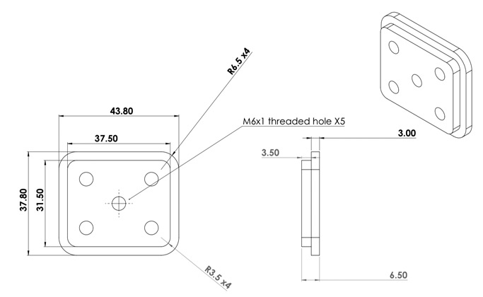

I finally got the Molle panel nuts I had made for the OEV Molle panels. They're 303 Stainless Steel with Black Oxide surface treatment. Trying to gauge interest. Rather expensive to make in low volume, but they come in around $10-$11 each if I can do a run of 250 pieces.
These look great. Did you mill them or print them? Interested in your process.

@MisterSmith Those 3D printed molle nuts are great. I don't even have Molle panels on our camper and I want some. Ha. What size are these nuts (sizing of OEV panel cutouts)?
I designed them in Solidworks and made a 3D print in plastic to test them... plastic is cheap. Once the dimensions were verified, I had them CNC milled from 303 Stainless with the black oxide surface treatment to keep them from rusting. I chose 303 stainless because it's got good corrosion resistance. I initially thought of using aluminum, but threaded aluminum is not usually a good idea. I will have some available for sale sometime in December, working on a couple tweaks.
The nuts are CNC'd from stainless, plastic 3D prints would never hold up. The dimensions are as follows.

I have talked to OEV about the Molle panels. "Molle" is used on racks (like the CAMP-X), as well as strapping systems you see on backpacks and soft goods. There is no oversight committee proposing standards, so it's pretty much a free for all for sizing. OEV makes their own panels, so they've got their own standard.
I never wanted to make these, but the only ones I found wouldn't fit the OEV standard.
Stay tuned for 2 more Molle nut versions... I have a vertical and horizontal coming that will allow some flexibility to slide the nut in the Molle panel cut out. The idea is that you would use 1 full size nut and one adjustable nut for most mounting jobs.
