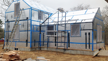

Here's some info on polyiso
That article is only viewable to members.
If you have a concern about polyiso, can you elaborate?
FWIW, we are more concerned about insulation against heat, than we are about cold. We can always put more clothes on, but there are only so many clothes you can take off...
Polyiso is better for heat. The insulating qualities of polyiso drops off at 35F because the blowing agent condenses......also depends on what type you get because each manufacture uses a different blowing (gas) chemical.
Polyiso is one of the worst insulation for absorbing water so I wouldn't recommend it using it with a wood frame structure.
Using an aluminized foil in the roof and walls will reduce the amount of UV that can pass through the roof/walls.

The polyiso we're looking at is the 3.5" R-Max Thermashield 3, which has an R-value of 23.9. It has a foil face. Twenty 4'x8' boards delivered to our home, for about $1,390...
And we're planning to completely seal the inside and the outside with epoxy before painting it, so we're hoping the moisture never even reaches the polyiso.
I'm of the mind give it time it will leak.
For the cost + time sprayed urethane is R6.25/in and a much better air barrier vs rigid insulation but both polyiso and urethane absorbs water so there is no tell tale puddle of water. Neither foam will ever dry out so the moisture stays in place until the insualtion is removed.
Make sure the polyiso is dry (hasn't been stored outside) and taping the edges plus any punctures holes with aluminum tape greatly improve the water resistance.
