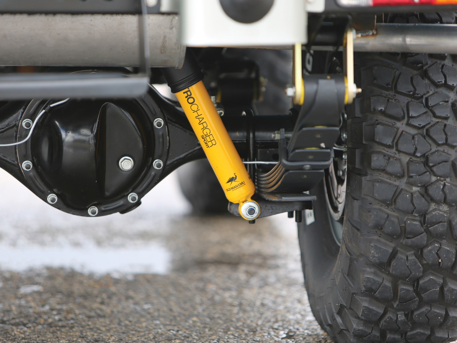

Unrelated question, but you posted the photo so it's your own fault... :D
How much of a pain in the butt was it securing bicycles on the roof of a tall vehicle? Considering ditching my hitch rack in favour of carrying bikes on the roof...
Well, I ditched roof racks for hitch racks because it was a PITA getting bikes on the roof. The final straw was when my wife ran her bike into the garage door and ripped the factory roof rack of her Jetta. We run 1Up racks now, which I absolutely love.
