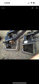

Next step. Pedals. Ended up ordering a RHD pedal box from the UK. In my mind, it would just drop right in. And it did not!
So.…. Turns out the 2 pedal setup has most of the mounts required to run the 3rd pedal. Requires a bit of fab though. Clutch and brake have to be cut and bent to clear the kick panel and put the pedals in the right place. The final productIMG_9947.jpegIMG_9891.png
