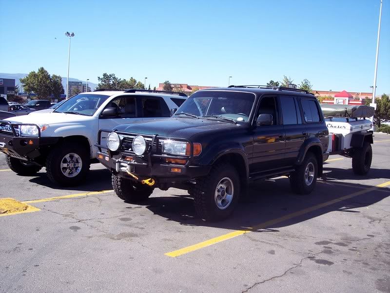

24HOURSOFNEVADA
Enroute to the 2007 ExPo Trophy.
The contents inside included; One Pelican Case (Size 1660) loaded with clothes/hygiene items. One ARB 45 Freezer fridge (Loaded to the top) with food items. Both of these items were in the rear cargo area. Along with other "little" items in the passenger compartment.
The truck was fitted with an Arb Bull Bar, Warn 12000 Lb winch with synthetic line.
Lightforce 240's
OME J Spring lift
255/85R16's on factory aluminum wheels. Matching tire/wheel combo in the stock location.
Stock rear bumper
The steer axle weighed in at 3060 lbs.
The rear axle weighed in at 2820 lbs.
For a grand total of 5880 lbs.
Weighing it with a fully loaded Adventure Trailers Chaser increased the weights to;
Steer axle 2920 (Lightened the front by 140 lbs.)
Rear axle 4880 (Increased rear weight by 2060 lbs.)
For a grand total of 7800 lbs.
The white 07 4Runner next to me was almost the same weight. I can't remember if he was a little more or a little less than me. I want to say there was like a 60 lb. difference. He also has a twin Chaser hidden from view.
Here's a picture for reference.
