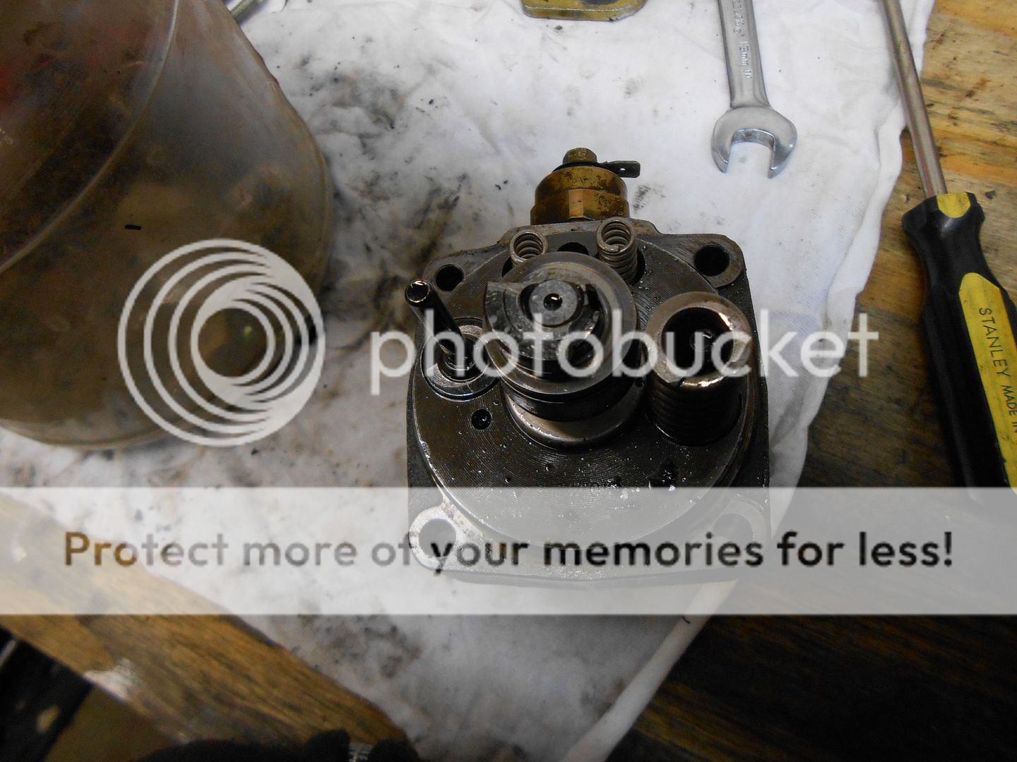

Welp I think the injection pump has to come back off again, after numerous adjustments and what not it still doesn't fuel near as hard as it did. Today I'll pull it off and go through it with a fine tooth comb and see if I can figure out what went wrong. After having numerous VE's apart this is the only one that has ever gave me any fits afterward.
pulltilbroke
So we dug into the pump and couldn't find anything wrong with it so I reassembled it and put it back on the truck. When I fired it it ran like total crap down low but it ran awesome up top but it had a terrible lope to it which led me to believe maybe it got out of time on the gear so I pulled the front skin off but everything was good there so we buttoned that back up and pulled the pump off fr the 4th time this week. I tore the pump down and found extreme carnage, somthing musta slipped outta place on reassembly. I ended up building another pump but this one still doesn't fuel that great but it does have good throttle response and seem t run real nice but just doesn't have the power it had. I will end up building another n/ic pump for the truck.
bftank
sorry to hear about the pump. although it is cool to see the pics of the insides. makes me a little less nervous to do the rebuild on mine when it comes time.
pulltilbroke
$#!t happens though. I did however score another N/IC pump so hopefully after get that on it will run like it did or better.
When you go through you pump make sure you do plenty of research and keep plenty of exploded views handy if your not familiar with a pump.
