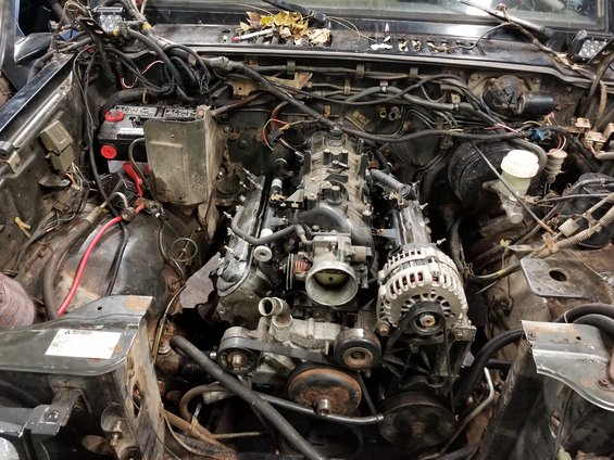

91 LWB Lq4 5.3 swap
4runnin
Couple final clearance shots.
yikes! you made it work!
fans in front of the radiator?
im assuming the engine is so far forward tbecause you lined it up with existing driveline dimensions?
4runnin
Moved it forward because I decided on a custom rad and efans. I was originally gonna go with a clutch style fan and move it back, but like u said I wanted to keep the driveline semi normal

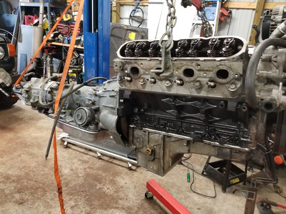

Update:
The weather killed me yesterday, wasn't able to get to exactly where I wanted. The hose fwas frozen so I couldn't finish cleaning and painting the motor.
But, the engine mounts are welded and painted. Oil pan was removed and cleaned, all gaskets were done. Boring stuff.
I'll have pics of everything going in tomorrow, finally have a day off to make some serious progress.
4runnin

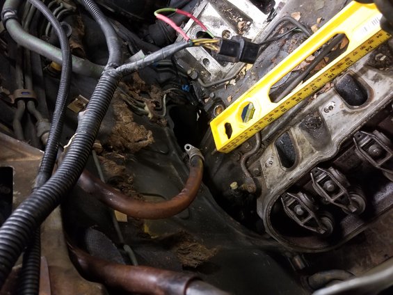

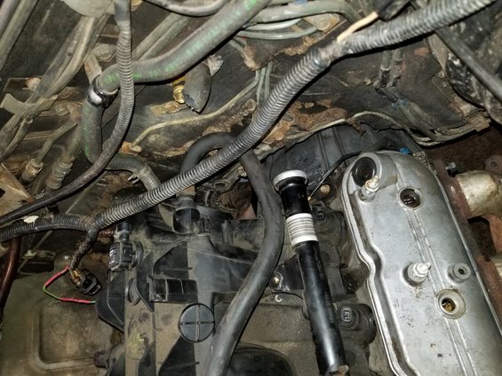

MOTOR IS IN !!!
Got her pretty clean

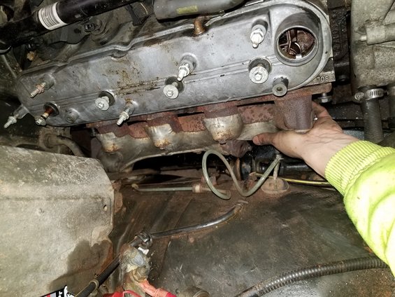

Header clearance is gonna be awesome, used the manifolds for a quick reference.
Clearance between the manifold and firewall are awesome
wow.
even the spark plugs....
