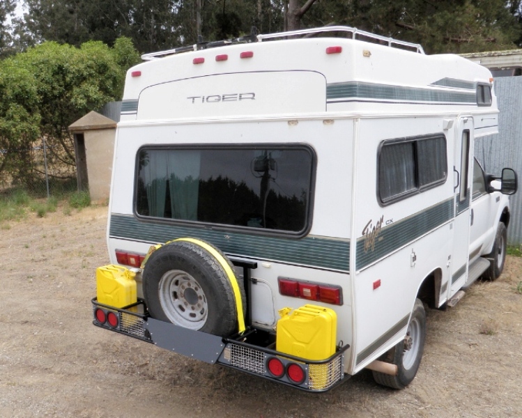

I can help you with with the rear bumper. Here is the one I designed and built for another ExPo Turtle owner:
I also have a design for a unique tool wrap if you have any interest.

And, a quick note to Don Joaquin: I saw and admired that bumper. Didn't realize that it was your handiwork. Very nice.
