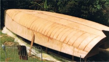

3mm ply will curve in a single plane really well and two planes with persussion!
you can also laminate thinner panels together if available

That's usefull to know, I wasn´t sure how curves like the ones on boat hulls were acheived, I had always thought that the wood needed a lot of 'treating' and setting to get it that way.
But I guess you´re saying that with 3mm ply it can be curved and fastened into place 'dry'?.
