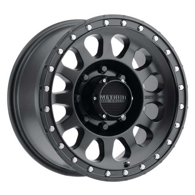

Method Racing Wheels has some that should work for you
Yeah,they have some 18's in these. 4500# rated.

I checked them so far out, but the Offset is always wrong, I don't want 0 or +18, I prefer it closer to stock and therefor at around +30.
And hub centric is a must for me.
Why don't they build proper wheels...

My CJC 315 17 x 8.5 Ram specific Methods rims are hub centric according to Cole there. They fit very tightly on the rear hub and front Dynatrac's.
Once again you're stuck with 3195# 17's though.
The 18 x 9's have the available 5.75 bs which hug the body quite well but I don't know if they are hub centric.
I like these 18" rims, you are right about the tires, with the 17" im stuck with the Toyo open country MT as the only tire with a 125Li.
I just mailed to DPP if they can change my order.
Shame on me i ordered the Saltas BEFORE i asked in this thread as i was sure that there are no alternative rims are around.
