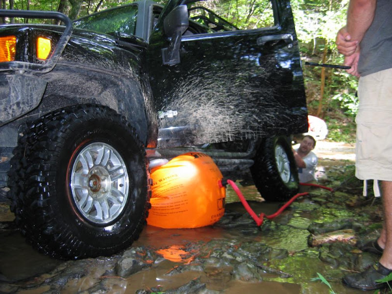

I've got one of these and have used it a few times..
http://www.airjackusa.com/
Front of truck was up on a ledge.. With the tire flat, I couldn't get backed off the ledge without landing on the bumper, so the tire had to be changed with the truck on the ledge.
In your images, two things come to mind. One, I wonder if you could have kept driving up the ledge. The pictures don't look that back, but I wasn't there and pictures never really do justice so forgive me if it was worse.
Second, the airjack still looks like it could have spit out. Point is, it could happen with about anything and is why care needs to be taken.

Token
There was another ledge in front of the blown tire.. Sharp point on that ledge was what blew the tire.
I hadn't noticed the air bag bulging out until I got back home and was looking at the pics.. I cringe everytime I look at it.. I also know now to make SURE the bag is setting correctly..
