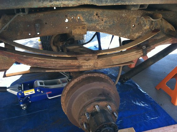

Here is what I started with on my 1 ton. It rode like a tank, and had almost no usable wheel travel:
Here is what I ended up with:

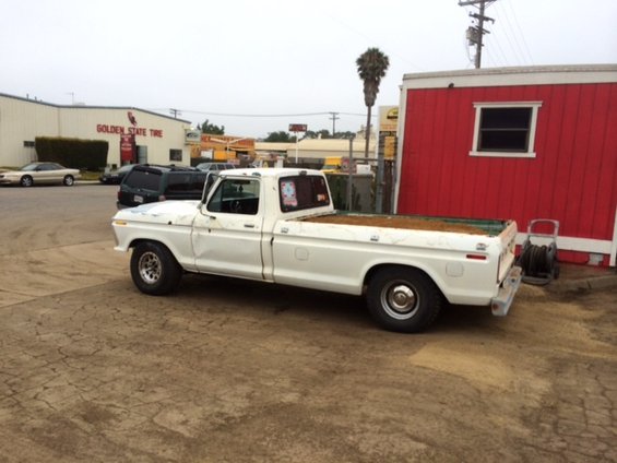

All I really did was pull 2 of the shortest leaves out as well as the flapper leaf, flip the lower overload upside down to let it have a little more compression travel, and I took the second longest leaf, chopped off the end aft of the center bolt, and stuck it on top under the spring clamp. It fights axle wrap but doesn't really add any spring rate to the pack.
The truck now squats a bit more under load, but at the same time it doesn't jar my kidneys driving around the block. I could put the upper flapper leaf back in with an hour of wrench time to help with the squat, or eventually add airbags. This is 2+ yards of wet fill dirt, and even though its on the bumps it drove fine the 15 miles back home:

Deuce, pulled shocks again - same as I remembered it, Hendrickson rubber blocks ride smoother. One would think 5 leaves shouldn't be that bad, but it is. Most older F-series use the same length/width springs, only exceptions are 2wd F150s and cab-chassis F350s which got 2.5" wide packs instead of the more common 3" wide. Springs we have are 2" lift for a 4x4 F150, so should be direct bolt-on in place of the 1-ton stuff. Minor snag would be the front eye bolts (9/16" for halftons, 5/8" for 3/4-ton and up) but since we're redoing the bushings with poly anyways we'll just use an inner sleeve for a 1-ton truck.
