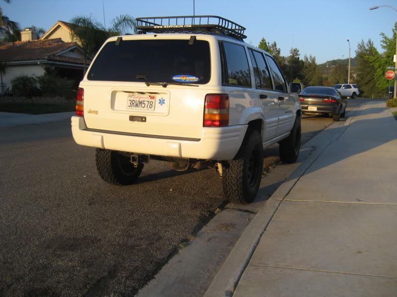

How it currently sits:
Well I purchased this Jeep with no intentions of wheeling it. The plan was to keep it for a year and then buy a TJ. Well it's been over a year now and I've decided to keep it for a while longer and build an expedition rig.
The Jeep is a 1996 Grand Cherokee 4.0 2wd. It will be converted to 4x4 as well as some other goodies by the end of the summer.

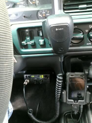

I added a CB with a PA that I got off craigslist for $30:
I had the antenna laying around from my old Samurai

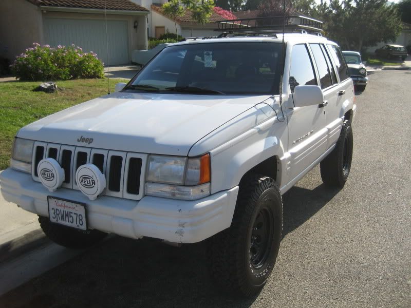

Installed some Hella 700's:

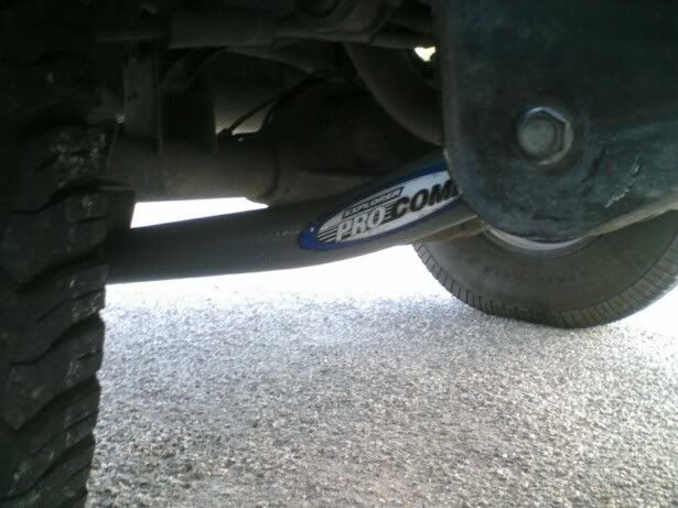

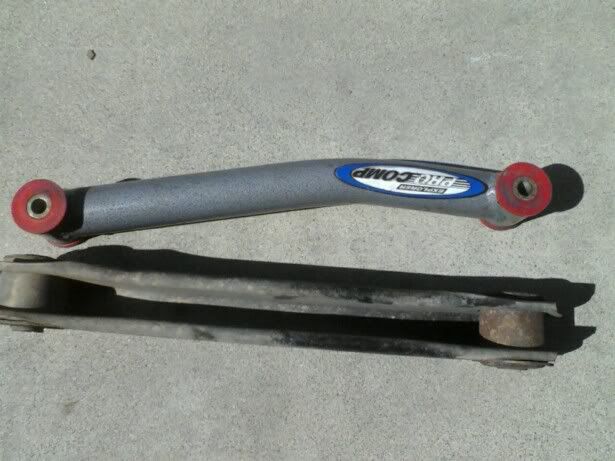

Today I replaced all four of my lower control arms for Pro Comp chromoly arms, they are the same length but much beefier. I'm at 3" right now and don't plan on going any higher so they should do:

wicked. those control arms are beef, dude!

I drove my Jeep on the freeway for the first time since I replaced my CA's and it appears that it helped with the vibrating issues I had been having. I think it's because my tires have a bit of negative camber now so it's sitting on the part of the tire that still has thread.

Your gonna hate that heavy fiberglass antenna on the fender mount. Get yourself a base loaded steel whip. Much lighter and it'll be easier on the mount.
