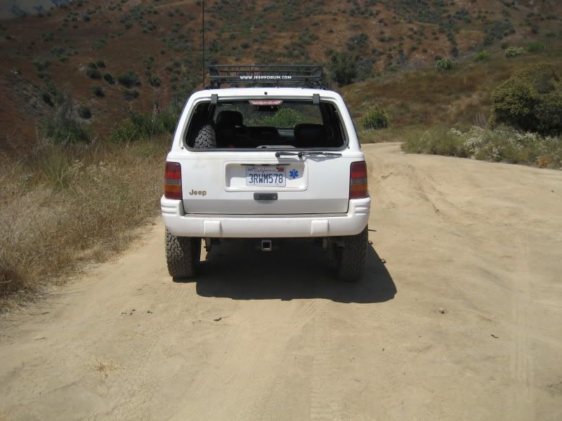

Whats the backspacing on the wheels? Have any clearance issues flexing the suspension?
I'll also be running a 33x10.5, hoping to pull it off with factory Canyons but not sure.
Your gonna hate that heavy fiberglass antenna on the fender mount. Get yourself a base loaded steel whip. Much lighter and it'll be easier on the mount.
4-3/4 I still need to flex her out, I think I'm going to have to trim a bit but nothing drastic. I'm lower(3") than most people than run 33's.
I hate it already, I need to buy a steel whip or move the antenna to the rear.
Amauri
Here you can see just how close it is to the rocker in the rear:
Overall:
The wheels will still tuck into the fender when I flex but I think I'm going to open them up more for appearance. Kind of like this:
He is at the same height as me with 32's.
