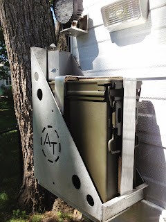

I use 25mm cans in a similar way. I have a carrier on each side of the back wall of my camper. I use them for fuel cans when needed, otherwise the ammo cans ride there. I made straps to hold them securely. It would be nice to have a larger can that would fit perfectly but these work pretty well. A few more photos here: http://travelswithrockythedog.blogspot.com/2013/08/new-storage-and-inverter-outlet.html
Looks good. I'm pretty sure the 25mm, 81mm and 120mm cans all take the same lid, so shortening one of the taller cans would result in something that fits in a jerry can holder just like your 25mm but would be just as tall as a jerry can.
