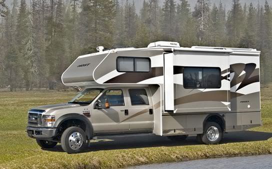

Here is a photo of the Host 270 on F550 crew cab chassis

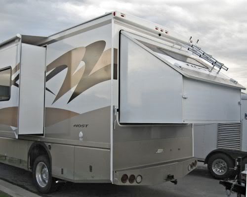

and here's that fold-down sleeping platform Jay was telling us about.
Note how the back window becomes a skylight for the platform.
Incidentally, Sprad's RV in Reno has a 2007 Host 270 advertised for
$107,000. It's got the 6.0L diesel, which means you can run it on
diesel with higher sulfur. The 2008 model requires ULSD.
