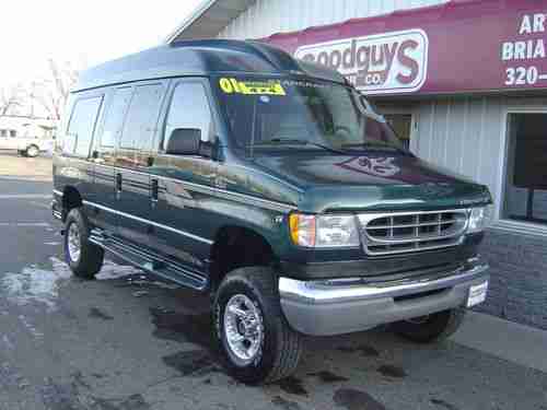

stilljeremiah
Trucks with camper shells are easy to find. A mega cab ram would be huge. Sportsmobile or full size van. That is what comes to mind quickly. Shopping for cars is fun.
