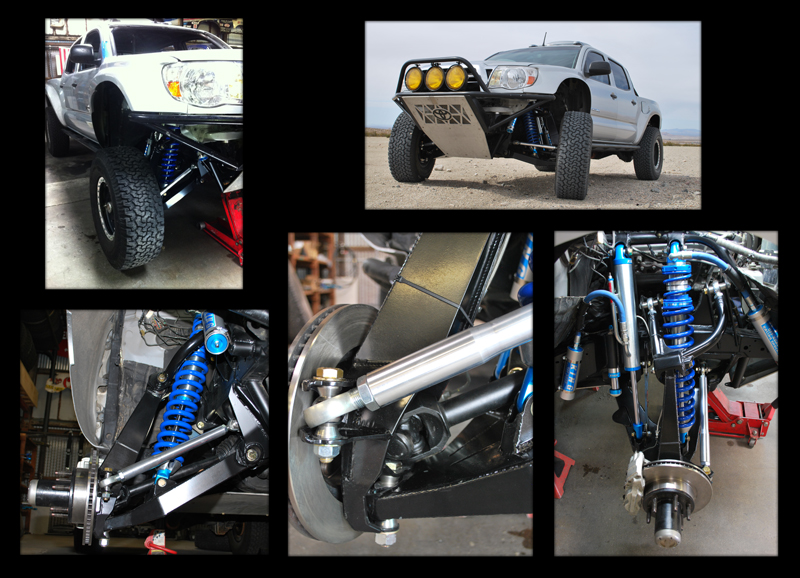

A secondary by-pass does wonders too! can really fine tune it to fit your style...better performing suspension does wonders for driver fatigue, worth every dollar..
I generally agree (I'm running secondary bypasses up front and bypasses in the rear), but yeah, the cost (up front) and added shock rebuilds definitely aren't for everyone, at this point you're talking many times the cost of an OME setup.
Here's my front end:
Nice!
Yeah not for everyone...comes down to how much you want to spend. Some guys are fine with OME's...others have to go full tilt. Believe Solo Motorsports has the longest travel kit out there at 19" for a Tacoa while retaining 4WD...looks BEEF! :D Once you have driven a nicely equipped truck it is real hard to go back to lowend, especially bouncing around Baja ;)
