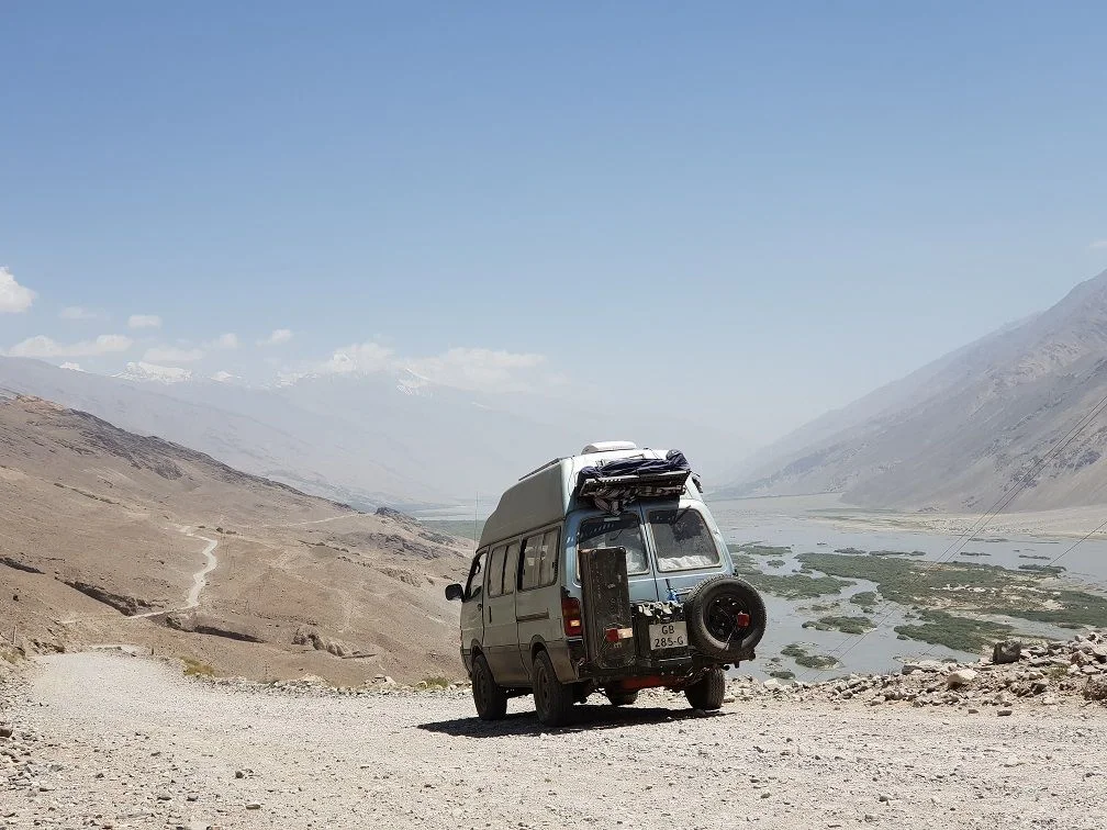

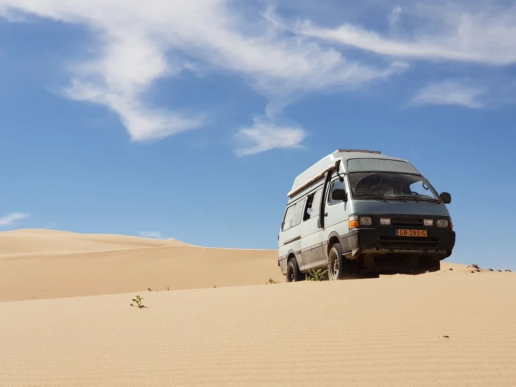

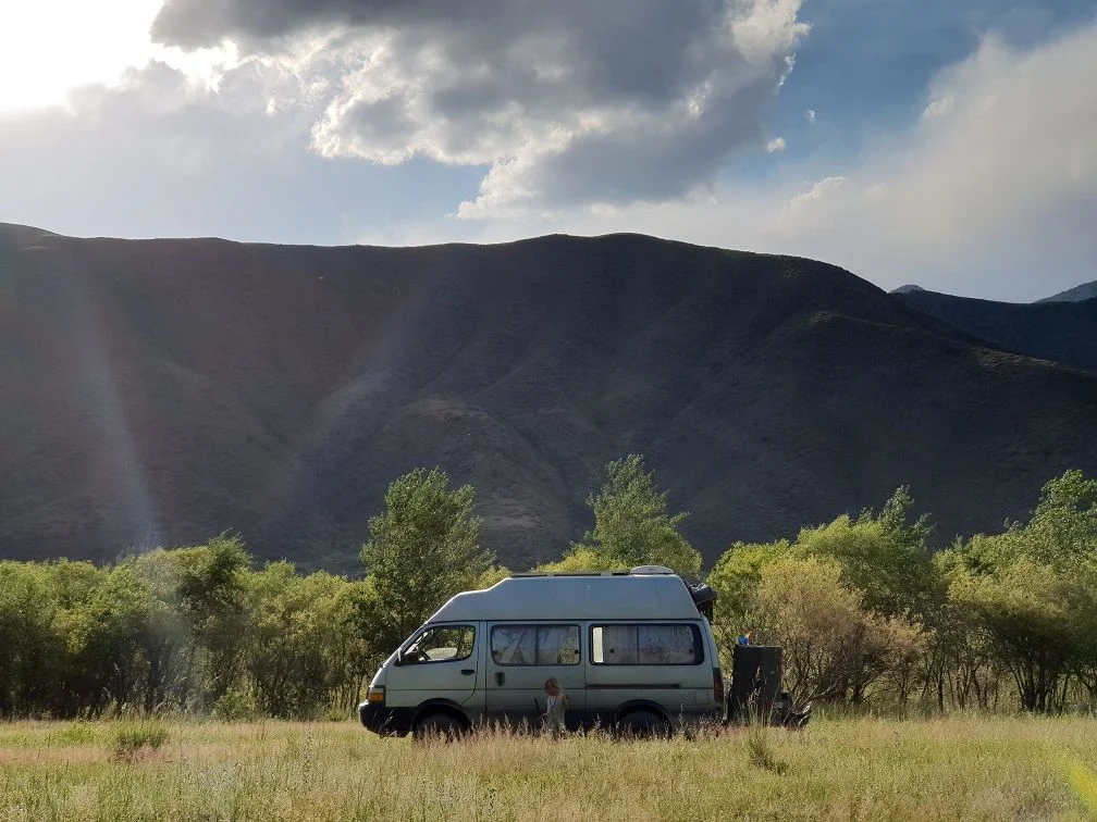

Yes, Dutch Hiace 4x4 owner here!
The Hiace took us from Amsterdam to Tokyo overland! (and a boat ferry) Via Russia, Central Asia and Mongolia
It has parttime 4x4 with low-gearing and a (factory) LSD in rear axle.
It is slightly modified as you can see :)
Engine is the original 4 cilinder 2L, 2.4 liter diesel without turbo ( as simple as you can get), so not the 1KZ engine
