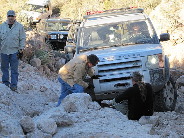

Shaun (05LR3AZ) uses his pretty well.
http://www.azlro.org/gallery3/index.php/2011-Adventures/2011-Arizona-Land-Rover-Rally/Ajax?page=2
Craig in our club does also, but I don't think he is on here.
