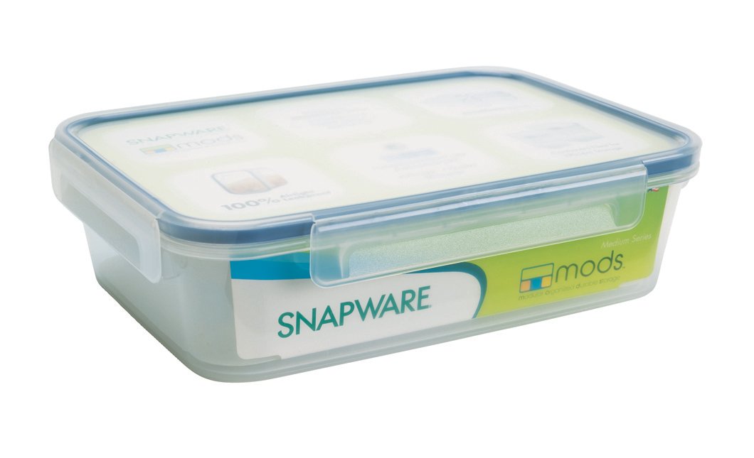

I have some bedliner (I think it's Duplicolor) but I'd like to have some sort of waterproof enclosure for the aforementioned module. Does anyone have any suggestions?

I like the food storage containers with the click-lock type closures (there are a bunch of different brands) with a separate seal. Very cheap and very secure - and available in pretty much any size you would ever need.
http://www.amazon.com/Snapware-Rect...111?s=kitchen&ie=UTF8&qid=1390307229&sr=1-111

Possibly relocate it? I relocated some of the control modules in my old Tundra. Also mounted the amplifier under the passenger seat on 1" stand-off spacers to keep it up off the floor board for that exact same reason.
Only thought on putting it in a sealed container is the heat generated by the electronics, may be negligible, not really sure over time though.

I vote for a relocation. I recently relocated my fuse box to higher ground for this reason exactly.
