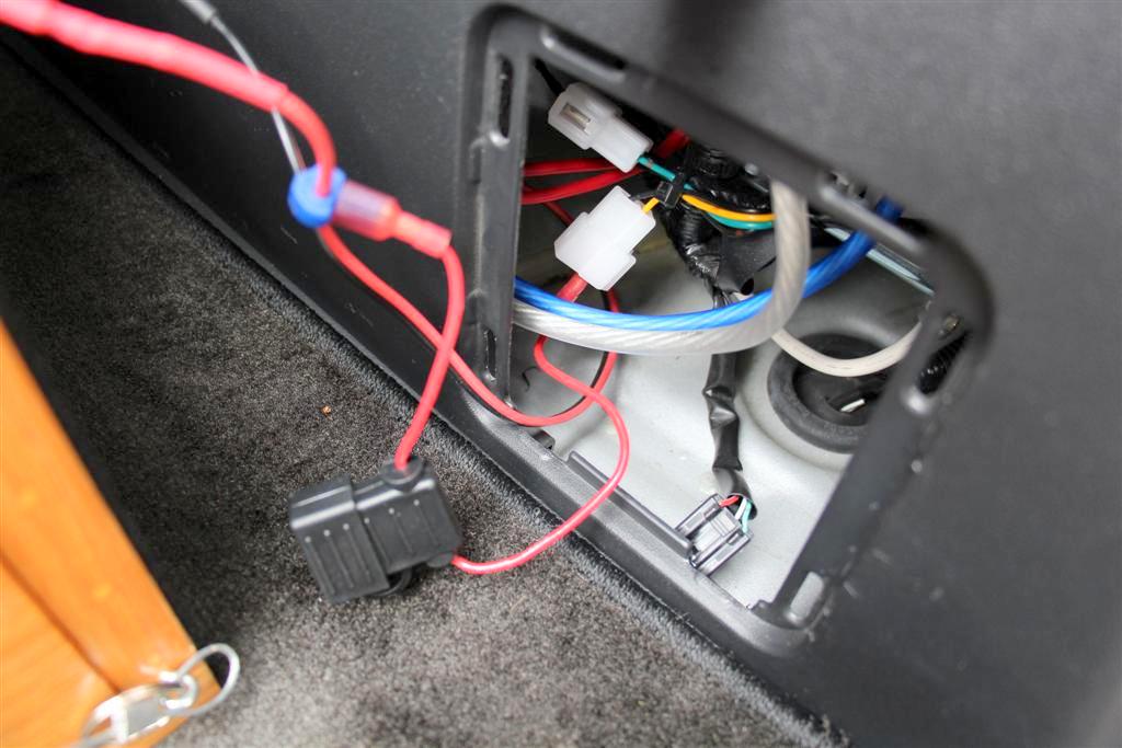

What is the best way to keep the fridge on if you don’t have a rear outlet in your vehicle? My 2014 FJ has everything for off-roading (crawl etc) from the factory but no outlet in the back...
Corey
OverCamping Specialist
What is the best way to keep the fridge on if you don't have a rear outlet in your vehicle? My 2014 FJ has everything for off-roading (crawl etc) from the factory but no outlet in the back...
Do like I did in my FJ Cruiser.
Install a dedicated 12v plug in the rear, run 8 gauge wire to a fuse about a foot from your battery.
Mine is hooked to my aux battery though with the blue and gray wires you can see below.
Run the wire behind the right side panel, and drill a hole for a plug.
You can see the single plug below the ARB one gallon air tank.
The other two 12v plugs are wired up to thinner wire that will not support the startup voltage my National Luna fridge requires.
I tried with those plugs, but the compressor in the fridge would not even start.
