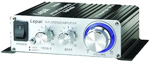

The amp is this one...
Mike suggest the amp (I have one too) and told him they are junk...What was junk was the speakers I though were good...Those Gallo's, powered with that $20 amp sound as good as anything I've heard...The amp will fit in that notched space in the dash, to the left of the steering wheel...It will be independent of the "house" stereo...
Awesome can't wait to see the finished product!! Does that amp say Lepai? is that the brand? Got me fired up to find a rig!! (sold the Sprinter)

It does and it is. Check it out here:
http://www.amazon.com/LP-2020A-Lepai-Tripath-Class-T-Amplifier/dp/B0049P6OTI/
Down to $18 now. And when you're there, you can read through the 1648 reviews. ;)
BTW, as will be clear later in the build, the wonder of this amp--even more than the fact it's credible for $20--is that it'll fit in the otherwise mysterious (and so far, to me, useless) cubby in the lower dash of a T1N at 8:00 relative to the steering wheel center. Though I've seen Scangauges mounted there, it's way out of your line of sight and you need to be looking at a Scangauge often when driving. It seems like it'll be perfect for something where you just need to read down and turn a knob occasionally.

Is this amp for just testing speaker placement or the amp to drive the house speakers? Pretty low power output. Thanks for sharing this!
The Gallo's will only be wired to the $20 amp...The 'in-dash radio' will have no connection to the Gallo's and the amp...Two separate systems... The audio input for the Gallo system will be a mini-plug or a Bluetooth device...

A few reasons. I'd expect impedance issues and can almost guarantee the current head end would not satisfactorily drive the Anthony Gallos. The existing head end is an older Panasonic unit which, while a huge upgrade over the OEM Sound 5 unit, is still a $100 unit with no Bluetooth, USB, SD card or AUX capabilities. So it would need to be replaced.
It can only be replaced with a single DIN unit, and the positioning is not good for using a single DIN unit with a fold-out screen, so the possible replacement head ends wouldn't be anything special . . . no chance of installing a fancy do-it-all NAV/DVD/HD etc. unit. But even if replacing the existing unit with a modest head end, I'd probably need a separate amplifier, so there's some more cost. And taking apart and putting together the Sprinter dash and running wiring around its innards is non-trivial, and even though Paul can do it about as well as anyone, he's got bigger fish to fry. This separate approach will be quick and easy and cheap, and will likely produce superior sound.
BTW, so that no one is confused . . . the Gallo/Lepai setup is just to provide optimized music for the driver, sourced through a Bluetooth receiver or a mini phono jack. The current head end will still provide AM/FM/CD for the whole cockpit, and I'll be replacing the factory dash speakers with 4" Polks later on so it will sound better. And none of this has anything to do with the "infotainment" back in the cabin, which will be an entirely separate system, basically all wireless, that will be installed after Paul finishes.

It'll be enough power for the use. This will be very much a near-field sort of application, so there's no question of filling any particular space with sound. Also, there's basically no LF to worry about powering, since the Nucleus Micros don't even bother with anything below 100 Hz. It's also worth considering that the van is a pretty noisy place, so even if the amp ever did clip the signal, I doubt I'd know it.
And they're decently sensitive, being rated at 89 decibels . . . which may be no great result compared to 110 db for vintage Klipschorns, but they wouldn't fit. :sombrero:
As I said above, this setup hasn't got anything to do with playing music in the van. It's more like sitting at the computer screen with speakers on either side. It's nothing that requires much output.

I have the same amp and agree its great for $20. Glad I could contribute to this build thread, you are welcome.
