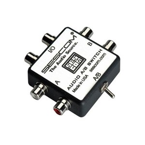

How about a simple A/B selector switch, have your speakers fed by both devices and just hit a button for which source you want to hear?
There's all kinds of styles and types.
