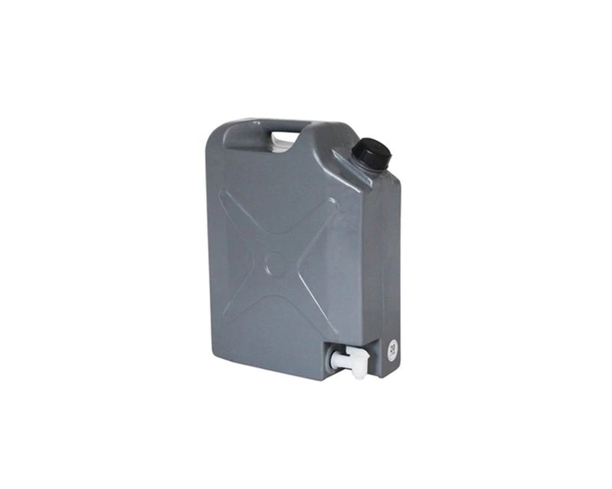

I am not soo sure on the ones witht he spout on the bottom, here in AZ, hard plastics become rather brittle in the sun, and a leak/breakage would be highly probable if I were to get one of these. However, depending on your location and you use it might be an excelent find.
The Scepter can are much better IMO, due the durability of the product.
