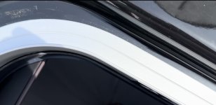

Brad2064
Hopefully you can tell from the picture but this is the aluminum shroud of the hatch and the black is the exterior fiberglass shell/roof. No gasket or caulking. I can’t tell if there is something under the aluminum but from the leaking I suspect not.
