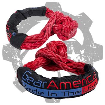

The knot is called a button knot. An unholy blend of a wall knot and a crown knot. Developed by Brian Toss
Breaking strength of 50 TONS

Be careful with using homemade soft shackles. The stopper knot should be tensioned with the right tool.
Meh, it’s like anything else. If you do it wrong. Splicing and rope work is fun and satisfying. Rope work is an ancient craft going back centuries. Probably since humans first needed to tie up their dog or set a snare lol.
there are several knots you can tie, button knot, diamond knot, even an overhand knot. Www.knotsbygrog is a great resource.
your post actually mentions pliers to finish dressing the knot. These high modulus ropes are very strong but their weak point is ‘picking’; they are vulnerable to chaffing. Steel cable is much more durable, but it too can be dangerous if used wrong.
thus using pliers can pick the fibers. That’s not good.
Some people use a winch to do the final tightening, some use a high lift jack, or simply use it for a recovery and it will tighten itself.
some people buy an expensive set of fids, while others use big knitting needles or tie even a wire onto the end.
to say only buy them and not make them because home made ones are faulty, is like saying that self sufficiency is a bad thing, and it is impossible for a person to make their own and make them properly.
Your post was written by a company that wants to sell their product. Nothing wrong with that. Nothing wrong with making your own. To each their own.
