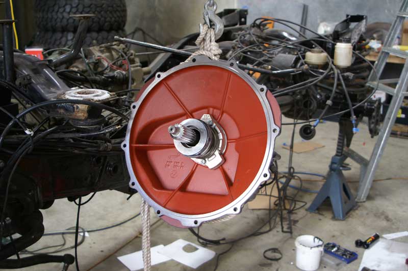

Second question pertains to bleeding the clutch; the fluid is dark. This U1350L does not have a PTO. I cannot find a slave cylinder on the bell housing, but there is what appears to be a bleed nipple at the top rear vertical axis of the housing. Is the slave inside the housing, perhaps on the throw out bearing? If so, I assume that a gravity bleed would work for refreshing the clutch fluid? Is there somebody out there with a similar truck who has had experience with this set up?

Best thing to bleed the brakes and the clutch is a pressure bleeder, gravity bleeding will only work if there are no air bubbles in the system. I got one of these, http://www.motiveproducts.com/, it works great, makes bleeding the brakes a 10 minute job. It also makes bleeding the clutch very easy as well. The bleed nipple on the bell housing is for a hydraulic throw-out bearing, no slave cylinder required,
