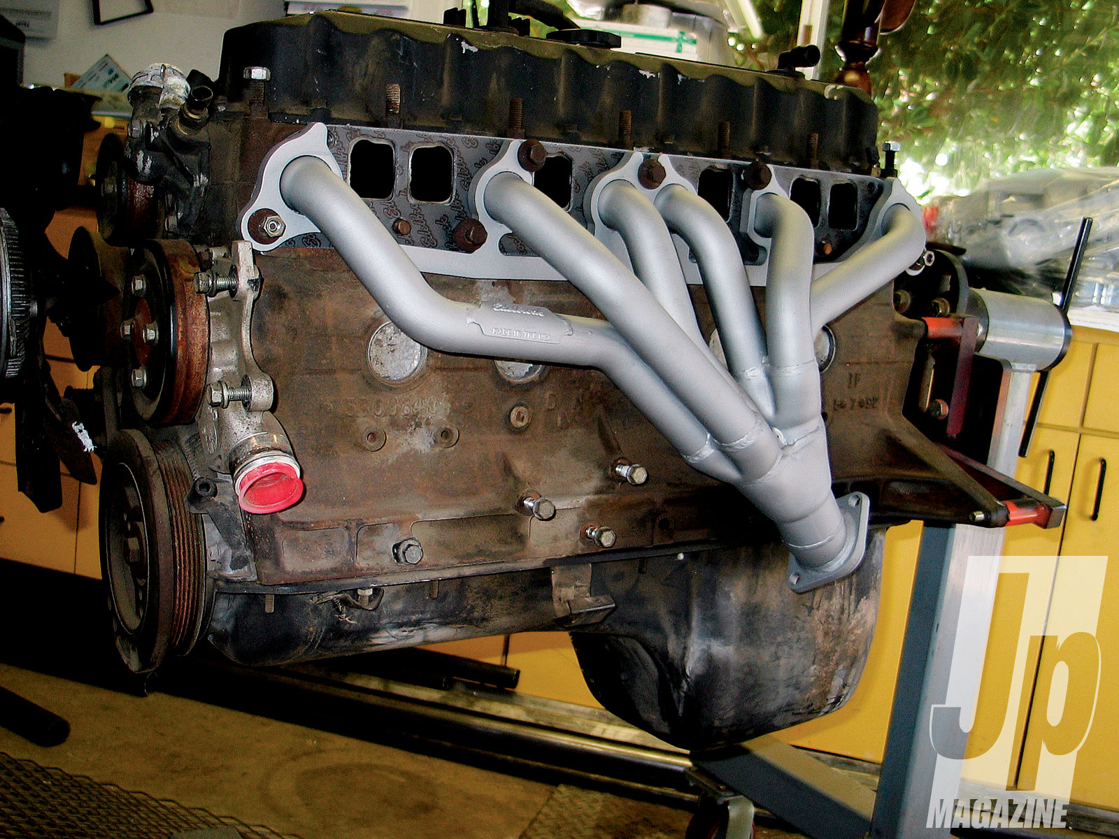

The gingerbread man brought a long awaited piece for the XJ, its the ceramic coated exhaust manifold. JET HOT does this chrome color as well as a satin grey and then all the other colors you could want. It comes with a lifetime warranty and I cant wait to see how cool the engine is.20191014_100121.jpg
