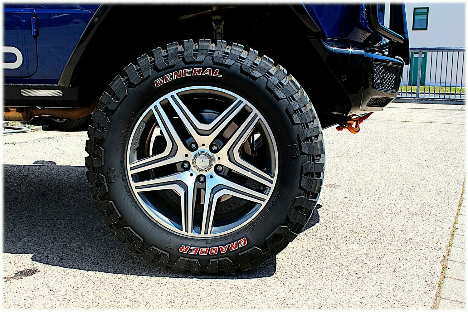

Hi guys,
I'm talking with Braid to have some custom 17*8 G ET 33 wheels made since I really like the tire options in 17" and nobody else seems to offer a 17" now. The Thor G10s in 17*8 ET 25 that I'm running on my 14 G550 are awesome but apparently no longer being made and the ET25 is a cool looking stance but maybe just a hair too aggressive... Wondering if there would be interest by others. Goal would be a sub $500 light 17*8 ET33 wheel in anthracite that would work with the OE MB bub caps.
Would others be interested in a group order? Ideal tire for the G in my opinion is BFG Ko2 in 285/70-R17 in a C load rating. Night and day difference in comfort vs my 05 running 275/70-18s E rated BFG Ko2s. Much more comfortable than stock with added sidewall!!

FYI the german GFG used to offer Braid in that 8x17 for the G. They came with the notification "Not for winter use" as the coating was unable to tolerate salt.
They no longer offer them in their shop.

I wonder why the finish doesn't hold up to salt... Its supposed to be powder coated.
