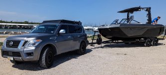

FYI - I've had zero issues towing with my setup. I love it. I towed the Boreas XT a few thousand miles on and off-road. I tow my Nautique shorter distances. All with no airbags. Just the heavy duty, stock-length Lovells springs and Ironman Foam Cell Pros. The boat and trailer is about 7,500 LBs. There is a little sag, but not enough to bottom things out or make the front too light. The pic below is at a weird angle, but the rear only drops about an inch max when hooking up. The correct combination of springs and shocks makes all the difference.
Regarding reliability - Mine is a 2020 with 86k miles. Zero issues except for some damage I did on a more challenging trail, which was totally my fault.
